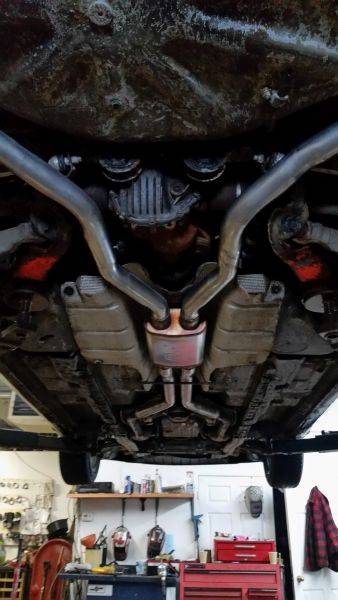

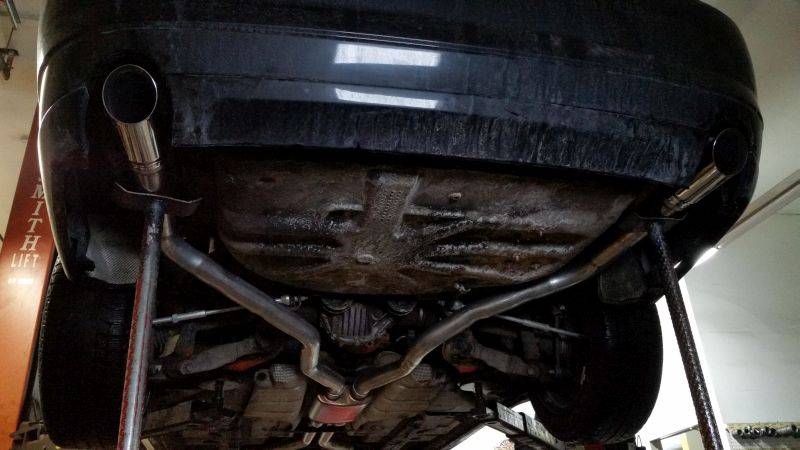

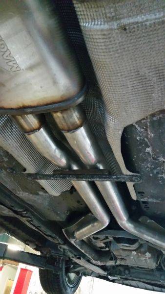

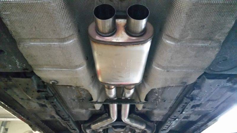

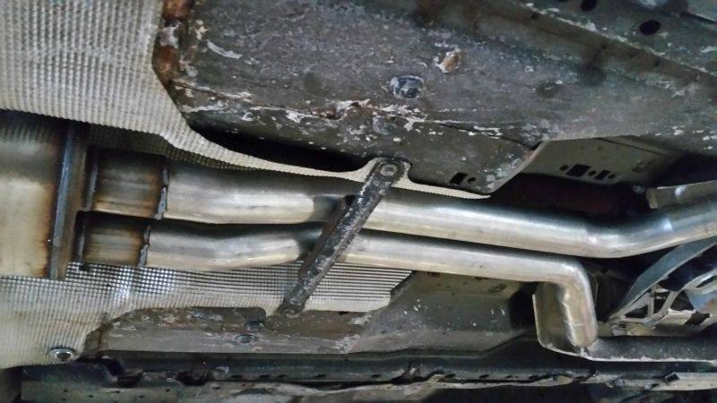

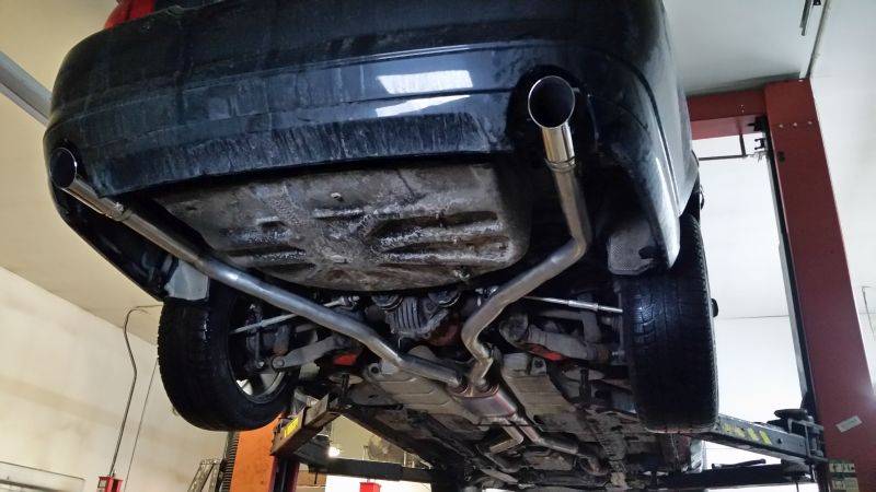

Had the 04 LSE V8 fitted with a custom exhaust this morning ... very BEAST and plenty of DRONE, just the way I like it.
Magnaflow # 11386 - 4" x 9" x 14" Dual In/Out Satin Stainless 2.5" True X core design.
Third CAT and Resonators deleted, 2.5" (not SS) piping, chrome tips added. (removed from 01 LS V8)
Very pleased, guy did an excellent job on it, I much appreciated his attention to detail,
everything lines up nicely. 3hrs total labor time, 400$ cash out the door.
Magnaflow 11386 ~ TRU-X Performance Core
