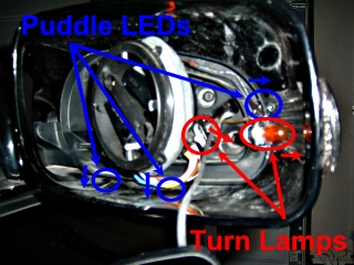

Here's what I did: I then: I also drilled in 3 puddle
lights:

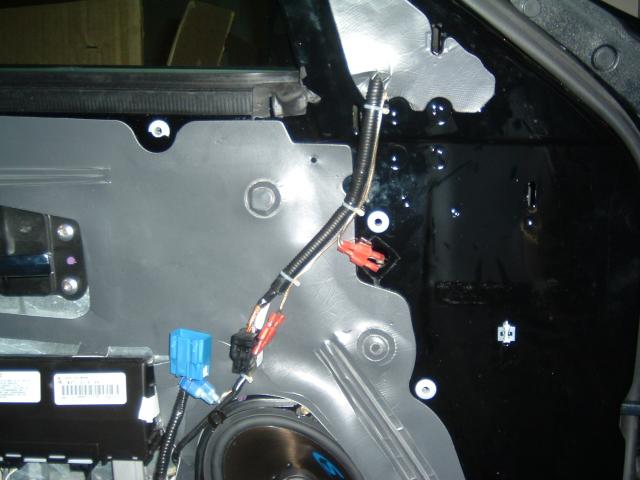

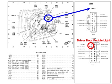

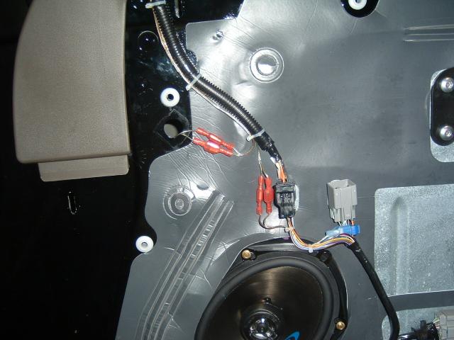

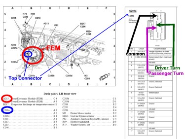

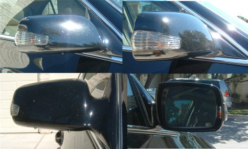

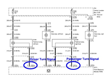

I then wired the lights up: Here's the diagram for the turn signals: Here's the driver's door: Here's the passenger door: Hooking up the signal wires were tricky - as the LS uses a multiplex wiring system - there is a Front Electronics Module: The final look:
