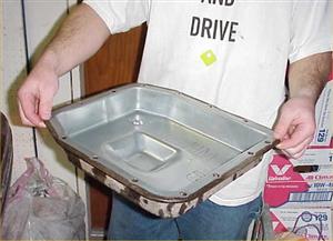

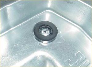

Here's a picture of the Ford 4R70W transmission pan with the gasket sitting on top. The OE gasket is re-usable and is stamped as such shown by the red arrow on the right side of the picture below. Notice the grey colour donut magnet shown by the arrow on the top left of the picture.

Using rags or paper towels and solvent clean the interior of the pan and carefully remove the sludge from the pan magnet at the bottom. Clean the edges of the transmission that the gasket touches. A rag or your scraper might be needed to get any rubber that's stuck on. This surface must be very clean to allow a good seal when you put the Lincoln Town Car transmission back together.
Clean out the transmission pan and remove all remaining parts of the rubber gasket around its edges. You might notice a metallic film on most of the pan surfaces that will wipe off. If you find a little plastic plug with a rubber O-ring, discard it. This was in the dipstick tube while the engine was assembled on the assembly line and falls into the transmission pan.
LINCOLN TOWN CAR, TOWN CAR,  LINCOLN, LINCOLNS OF DISTINCTION, TRANSMISSION, MERCON V, TRANSMISSION FILTER, TRANSMISSION FLUID, CLUB, PARTS, REPAIR, PHOTO, torque converterLINCOLN TOWN CAR, TOWN CAR,  LINCOLN, LINCOLNS OF DISTINCTION, TRANSMISSION, MERCON V, TRANSMISSION FILTER, TRANSMISSION FLUID, CLUB, PARTS, REPAIR, PHOTO, torque converter
The clean transmission pan. Don't lose the round magnet that's in the bottom of the pan! It goes on the little bump and it collects any metal shavings that might be floating in your fluid. Take it out and make sure it is clean.
