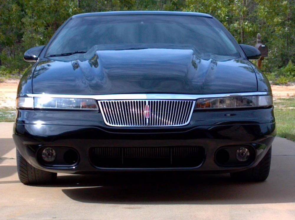

is that bumper cover mass produced somewhere? I have a 96 LSC pearl white I think it would look great on mine.
Nope, It was a custom one off I did a while back. Its a lower front of a Mustang sliced horizontally and split in the middle stretched longer to fit the Mark 8.
Not bad for a first try at it. I custom made it to ram air the air up into my intercooler tucked way back up in there. Plus I gained a set of fog lights too. I wish I was able to give it to another member on here to mass produce them, (as I would love to have a lightweight ABS plastic version in return), but this one was custom made to fit my car. It wouldn't work on factory Mark 8. I have my front radiator core and supports pushed back three inches, and down 2 inches. Everything is relocated in behind there to make it fit. ABS plastic would definitely be lighter than the fiberglass grafted unit it is now.
