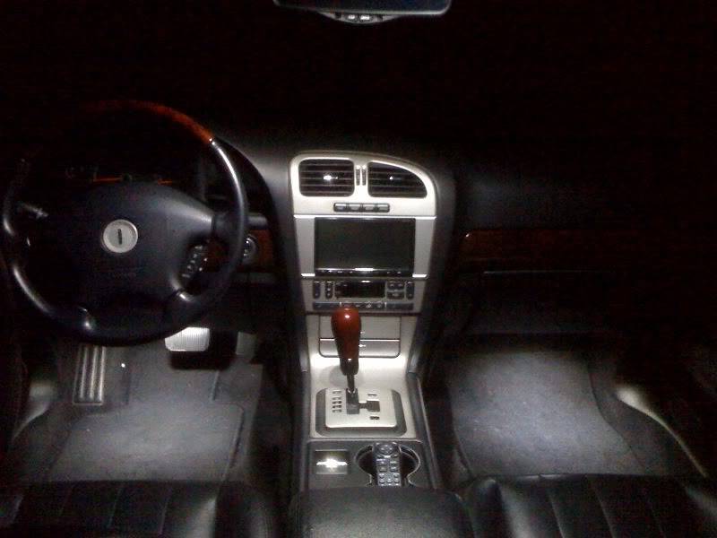

I went with something similar to these LED panels they carry at LSk, but I got mine at Pep Boys for a cheaper price & they work great & are bright. They also come in different colors.
http://www.lskoncepts.com/store/super-intensity-led-replacement-dome-194-168-12-led-cluster-p-251.php
I have 2 in my overhead map light, 2 under my dash (one on each side) & 1 in my trunk. For my rear map lights I used an 8 LED fuse style bulb. Here's a pic I took of my LED lights, but the pictures don't do it justice as to how bright it is:
I did the blue led's. Kinda sucks, because you can't see very well if you are looking for something. Looks cool though.
