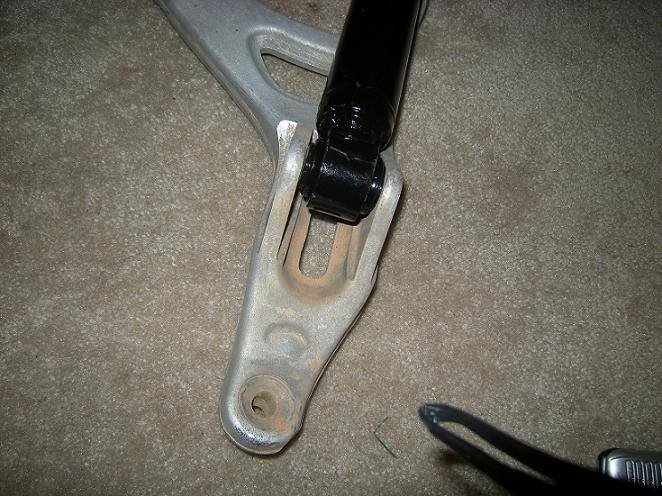

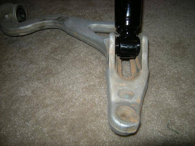

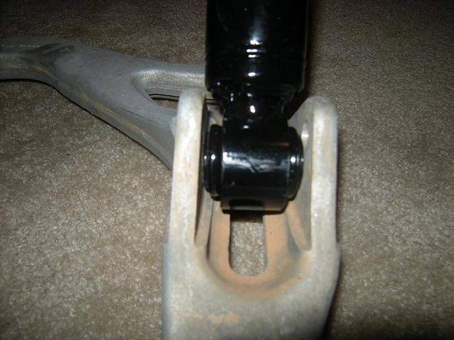

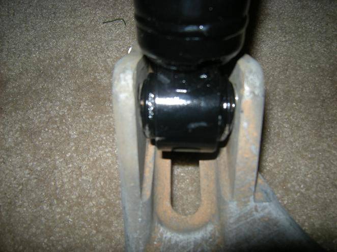

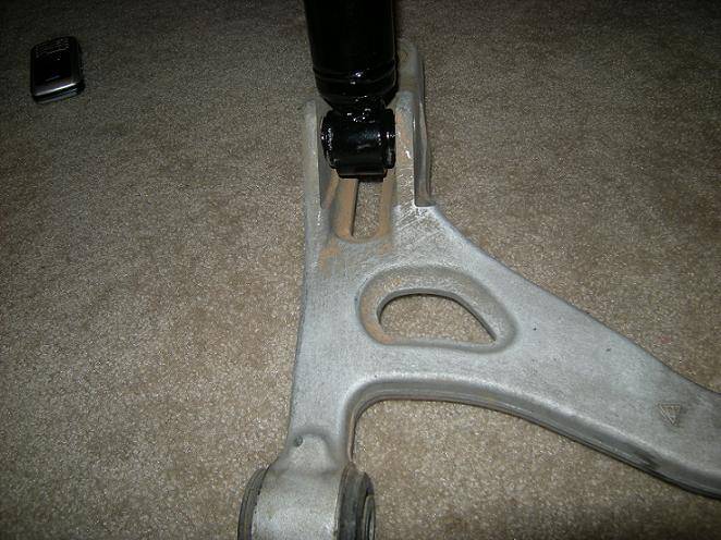

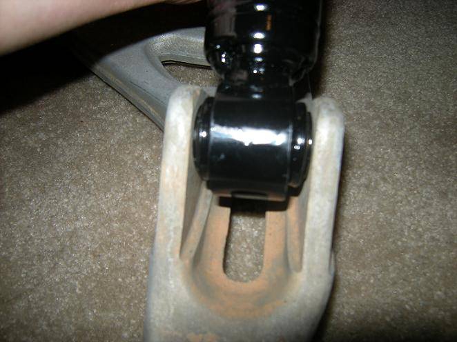

Well the Jag S Type V8 lower control arm came in today.
Here's pics with the Monroe SType shock on the SType lower control arm...
Shock fits nice N snug. Dont know if the SType lower control arm will fit the LS, i will see this weekend. From pics the LS lower control arm doesn't look different from the Jag. My conclusion at the moment is that just buy the Bilstein Sport shocks from the SType then use washers on the lower shock mount to get the fitment tight on the LS.
