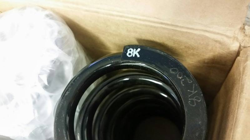

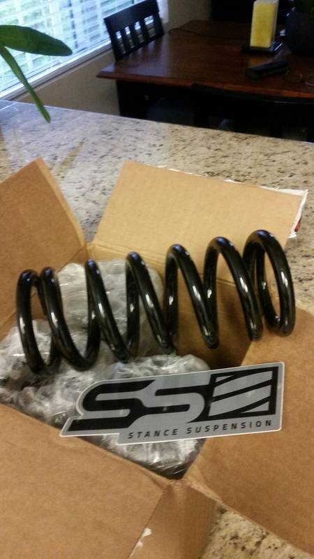

Just got some softer 8k springs from Stance for my coilovers. The original 10k were just a bit too stiff for me even at the lower dampening settings. This should represent a 20% decrease in stiffness with the ability to dial up the dampening as needed. Getting them swapped out on Friday and will let you know how it goes.
I had to do the exact same thing on one of my other cars that I had installed the Stance GT+ coil over kit. The softer springs made the ride much more livable on the street - and I still left the struts/shocks on the #1 setting (softest) unless I took the car to the track.

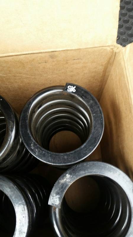

Interesting - was under the impression my Stance Coilovers came with 10k springs , however, upon removal they are stamped 9k. The new 8k's represent an approximate 11% softer spring rate and give me a ride closer to what I was looking for - a "Euro Sport" feel. I still have the dampening down at 2 or 3. If I would have known I was originally at 9k would have gone with 7k's since talking to Stance it's preferable to have the dampening in the 4 to 8 range. Overall, I am happy with the result and feel handling has not been significantly compromised yet they now provide a smoother ride.
