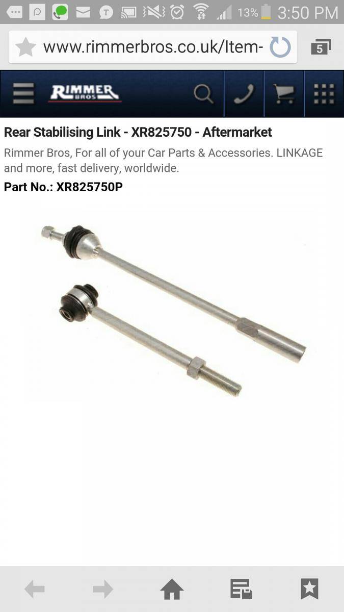

UPDATE:

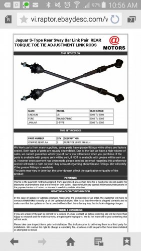

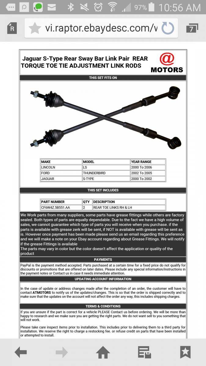

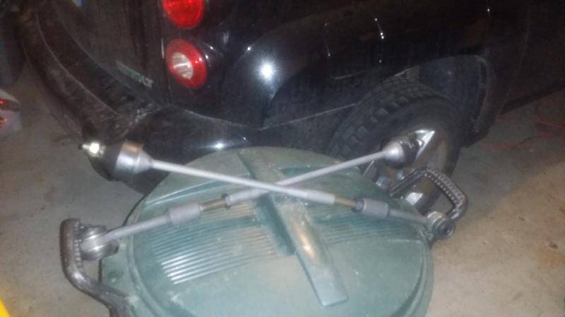

I just finished installing these formentioned JAG aftermarket rear toe adjust links from RimmerBros UK late last night, along with OEM Upper Control Arms and MOOG Sway bar end links. The JAG aftermarket XR825750 links are not clearly branded but they appear to me as DEEZA's. Structure and welding is identical.

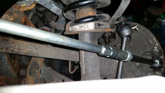

The only snag we ran into was at the wheel side end, the long bold which fastens to the knuckle at the spindle, the hole on the linkage, needed to be filed out with a round file so the long bold would pass through without having to beat it in with a hammer. Seems the inside of that pivot has some build up ribs. Each link just needed a few minutes of filing to make the long bolt pass through freely.
4 wheel alignment pending. We red-necked the rear wheels with the ol' tape measure trick.
Yes, those JAG rear Toe adjust linkages from RimmerBros UK fit just fine.
I did however have to round file the inside of the pivots to remove some sort of ribs that prevented the large spindle bolt from passing through freely.

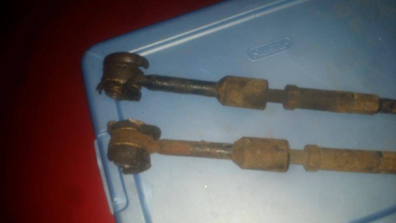

Recently replaced mine.. It made a world of difference. It seemed like my car had a different steering wheel in the back that I could not control.. The old ones were pretty jacked and this was the first car that I owned that has rear toe links
