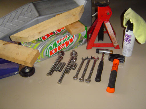

  1. Items/tools needed:
    1. 1 set of Rhino ramps
    2. 1 set of jack stands (or second set of Rhino ramps)
    3. Hydraulic floor jack
    4. Trouble light
    5. 1-pound hammer
    6. Rubber mallet
    7. 11/16" wrench
    8. 17 mm wrench
    9. 16 mm wrench
    10. ½" drive ratchet
    11. ½" extension
    12. ½" drive, 16 mm socket
    13. 3/8" ratchet
    14. 3/8" extension
    15. 3/8" drive, 13 mm socket
    16. 3/8" drive, 15 mm socket
    17. 3/8" drive, 16 mm socket
    18. Pry bar
    19. Drift punch
    20. 12 pack of Dew ;-)
    21. scrap wood 2x4s
    22. Zaino Z6 (or equivalent for clean up prior to engine start)
    23. Microfiber towel

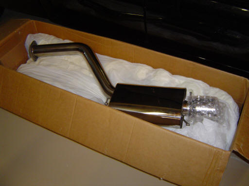

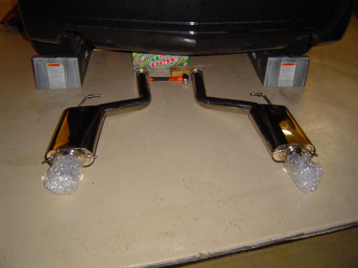

2.  Open up the B&B Performance exhaust box and admire the beauty of polished stainless!
cadillac cts performance exhaust

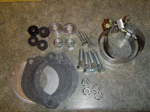

3.  Compare your hardware included with the kit to the bill of materials on the B&B installation drawing.
Cadillac CTS V

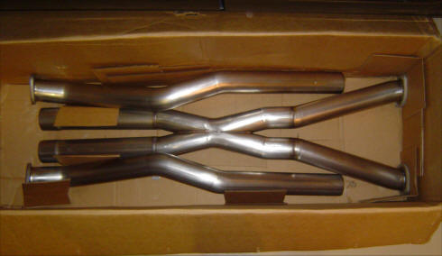

 4.  Oooo..x-pipe!

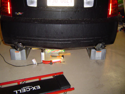

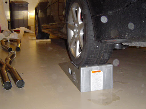

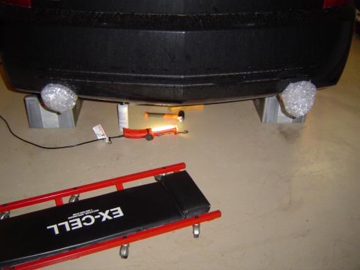

5.  Support the rear of the Cadillac CTS V on Rhino ramps.  Jack up the front and support the front of the Cadillac CTS V with jack stands (or another set of Rhino ramps).

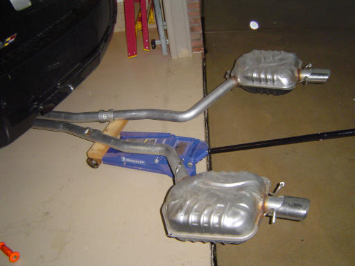

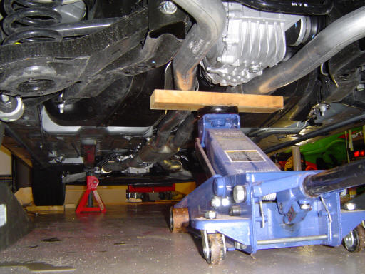

 8.  Place a 2x4 on the head of the floor jack, roll the jack under the rear of the Cadillac CTS V.  Line up the 2x4 under the exhaust just in front of the differential.  Raise the 2x4 up until it just contacts the exhaust.
Cadillac CTS V

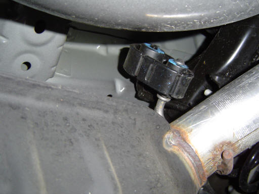

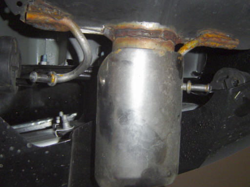

 9.  Slide the rubber muffler hangers off.  The hanger shown is towards the front of the muffler.

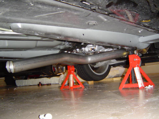

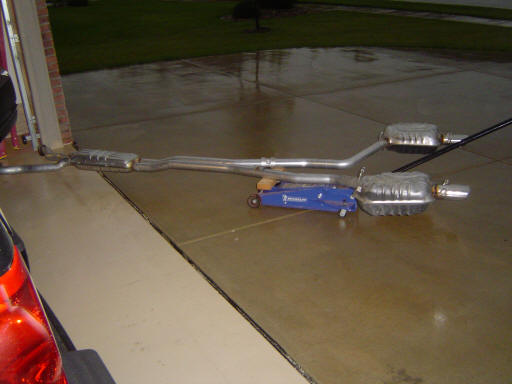

 12.  If you've placed the 2x4 in the position shown, the factory exhaust will be perfectly balanced and can easily be rolled out from under the car with the floor jack.
Cadillac CTS V
 13.  Oooo..balanced.

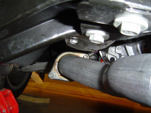

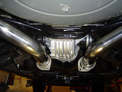

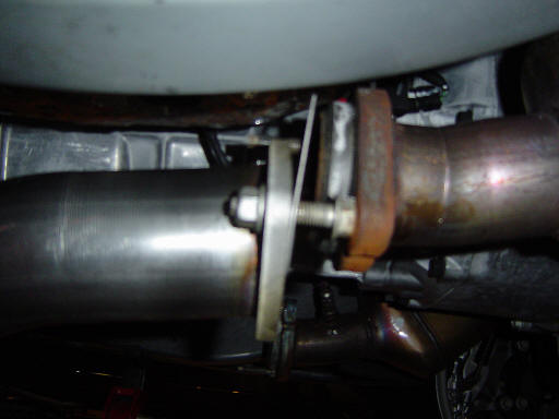

14.  Attach the two front B&B pipes to the factory exhaust manifold down pipes, using the metal gaskets in between.  Only start the nuts onto the studs at this time, do not tighten.

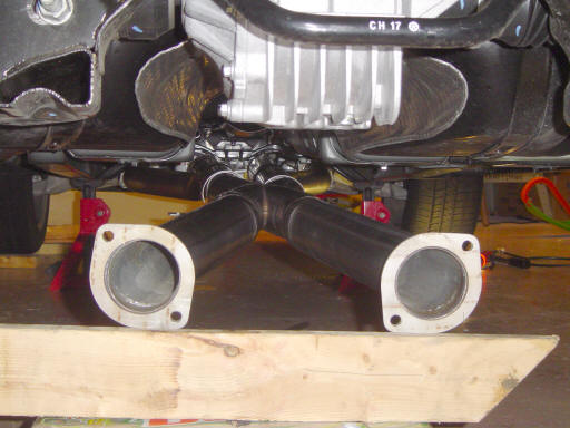

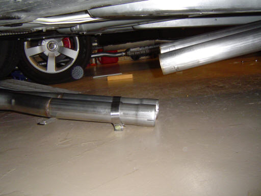

15.  Slide the two clamps over the x-pipe.  Make certain to orientate them such that the nuts are pointed down when installed on the car.  Then slide the x-pipe under the car.  Note the orientation of the center sheet metal tabs that are welded to the x-pipe.
 16.  Slide the x-pipe over the front pipes.  Make sure to fully seat the x-pipe over the front pipes.
performance exhaust

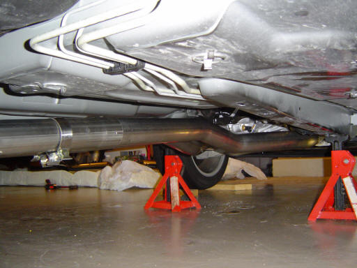

 17.  Support the rear of the x-pipe - I used a 12-pack of Dew and a 2x4 on edge.  =)  Use a 2x4 and a hammer to seat the x-pipe over the front pipes.
performance exhaust

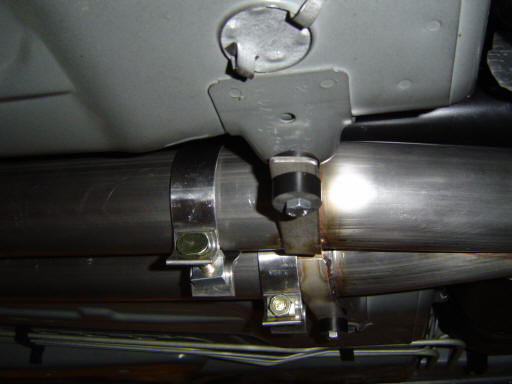

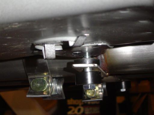

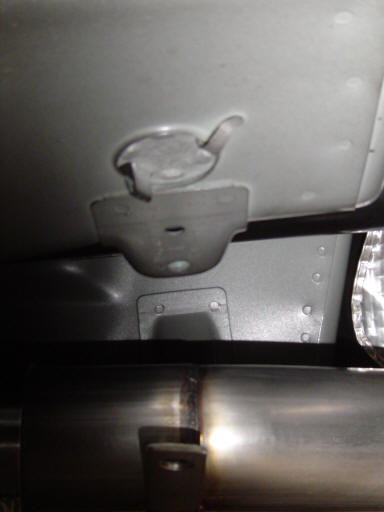

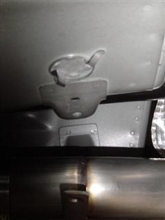

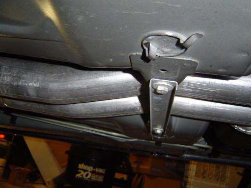

18.  Line up the center support on the x-pipe with the two holes in the underside of the V's body.
Cadillac CTS V
19.  Install the B&B performance exhaust supplied bushings (two thick & two thin) and bolts into the center support.
Cadillac CTS V
 20.  The thinner of the two bushings is on top.

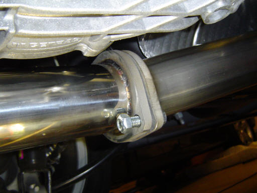

 22.  Line up the muffler pipes with the x-pipe.  Place paper gaskets between the flanges and install the two nuts and bolts in each.  Snug each side of the flange up evenly and tighten.

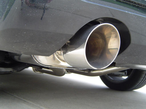

23.    Prepare for the unveiling. Performance exhaust!
Cadillac CTS V

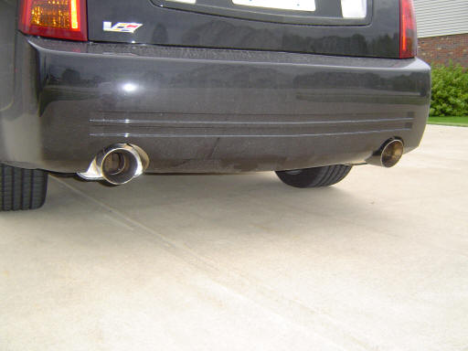

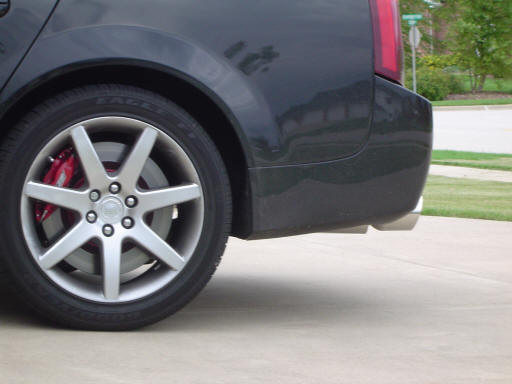

 24.  Look at those 4.5" tips on the Cadillac CTS V Performance Exhaust.WOW!

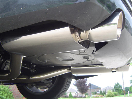

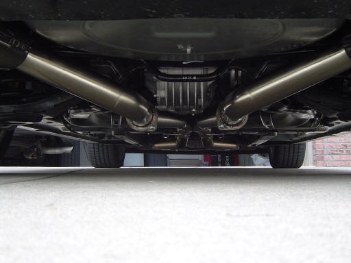

Photos after 6 good heat cycles and 100 miles later....
performance exhaust Cadillac CTS V performance exhaust
Cadillac CTS V performance exhaust performance exhaust
 performance exhaust Performance Exhaust!
