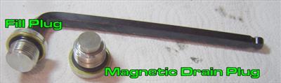

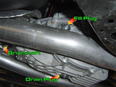

3. With the rear of the Cadillac CTS safely supported, remove the fill plug first. The fill plug is located on the driver's side of the differential, half-way up the side of the differential housing and is a bit tricky to get at with the exhaust pipe in the way. Use both ends of the 10-mm allen wrench to loosen the fill plug.

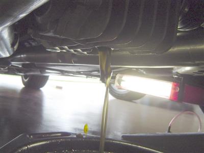

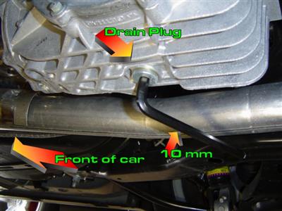

4. Position the oil drain pan under the differential and remove the drain plug with the 10-mm allen wrench.
Caution! Hot lubricant will come out quickly!

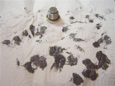

5. While the differential housing is draining, clean up the drain plug. Here's the "before" shot of my plug. The dark glob on the end of the magnetic plug is the metallic paste that has formed from normal bevel pinion gear break-in. This is important as there are metal particles collected on this plug, which is normal.

6. After the lube is done draining, install the clean magnetic drain plug and tighten snugly with the 10-mm allen wrench.
