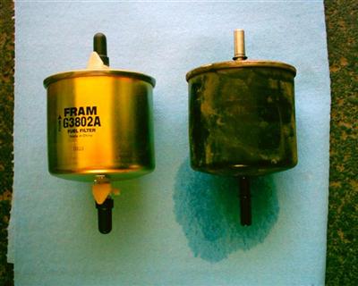

3.) Take out the Fuel Filter you bought and look at the body. It is a fairly large filter. There is an arrow on it pointing to one side that says "flow" point that towards the engine when you install it. Also notice there are two black plastic caps on either end of the filter. Do not throw these away as you will need them to plug the old filter to keep any existing fuel inside. (See photo)

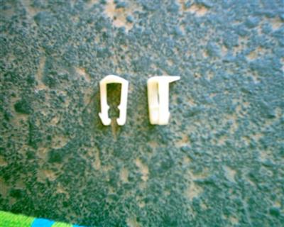

You will also see there are two clips that come with the filter, do not toss these away as you will need them. (See photo)

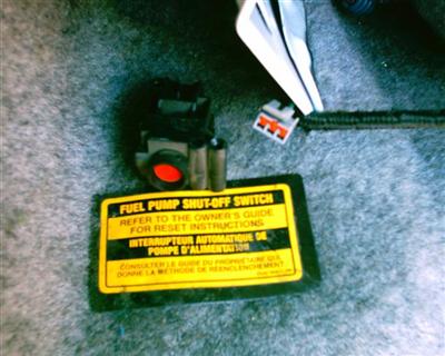

4.) You need to de-pressurize the fuel line. Follow the instructions in your Haynes Manual. One way to do this is to unplug the "Fuel Pump Shut-off Switch" located in the trunk of the car next to the trunk hinge on the drivers side (Pic. 1) There are two small bolts holding them onto the support. Un-bolt it and disconnect the wiring. (See photo)
Try to start the vehicle. If it starts, allow the engine to run until it quits, if it doesn't start, keep turning the key for a good five minutes. This will de-pressurize the system for you.

6.) With your screw driver, un-tighten the metal adjustable band that holds the filter inside the bracket. You can see it on the left in Pic 5. Take the screwdriver and pry out the existing plastic clips (Pic 4) that is holding the filter onto the fuel line. Be careful not to break the fuel hose housing. It may take a few minutes of wriggling the old ones out as you can see from Pic 4 that there are teeth holding the plastic clips in.

8.) Take the old black filter covers off the new filter(Pic. 3) and use them to plug the old filter. This should stop any fuel from escaping..
