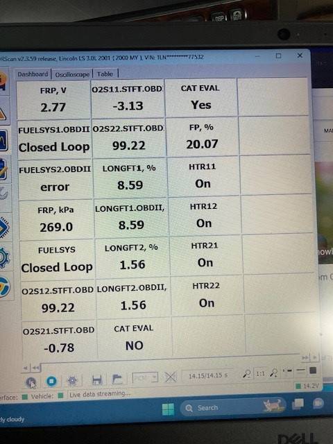

So here's a couple screen shots of today's run:
Note the error on fuelsys2.obdII; the 99.22 on both O2S12.STFT.OBD and 02S22.STFT.OBD. The 'NO' for cat eval, ctr bottom. The 323dtc lists the dtcs. B1869; P1000; P0442; P0442-p; U2008; u2005; u2003.
Bank 2 is left side, correct?
Check your plugs in that case, look for one or more that are wet, just to rule out an overfueling issue.
It is starting to sound like possible O2 upstream sensor issues, if we do have them. If you have an infrared thermometer, check your cats for consistency.
If you need a parts car, mine could make it there, lol. I am done with mine. It is still registered until 30-jun.
those are secondary trims with a default value of 99.92. the ptec was capable of using downstreams to do sub-trims but it wasn’t used
on newer cars you’ll see p2096/97/98/99 associated with the downstream trim
Yeah I looked that up and 99.2 is the default value. Means nothing. OK so I still have error in fuel sys 2 and no cat test on one side or the other. Thanks for info. What is ptec?
