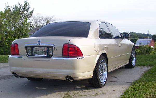

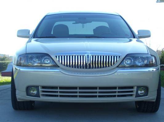

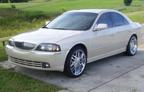

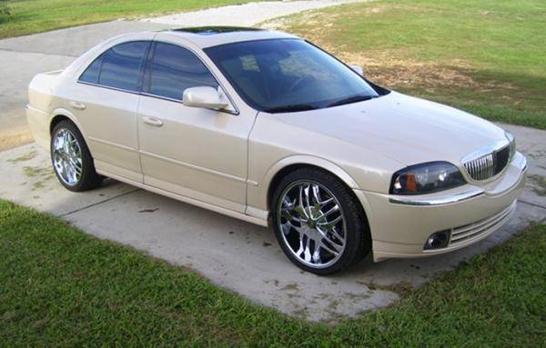

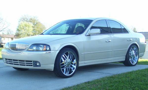

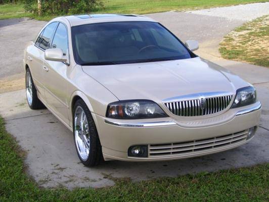

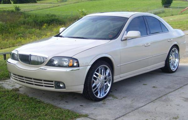

03 Lincoln LS This use to be my 2001. Old body on 2003 drivetrain with newer bumpers, lights, &

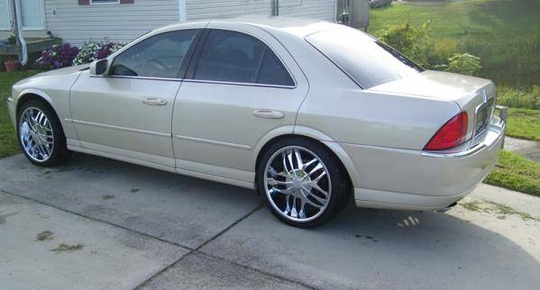

I had major electrical issues with my 2001. So I bought a totalled 2003 that ran with 70k miles on the 3.9L V8. Then I dissassembled both cars completely and used the 01 body on the 03 car. I had to put newer model decklid to get correct model taillights. Also put newer model bumpers, with newer HID headlights. Everything works great! Just took me a 1.5 years from beginning to end, including new paint, new 20" wheels, shaved emblems and all-red taillights.
