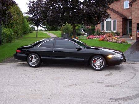

Blown stroked 5.0l DOHC Cobra motor,
Steel crank, eagle H-beam rod, CP piston, balanced
Ported DOHC heads, crower stainless valves
Cobra intake, shortened runners, IMRC deletes, 60 lb injectors, 2400 SCT maf
Vortech SQ trim, 2.7 15 PSI pulley
Kooks headers, 2 1/2 stainless exhaust, 50 series flowmasters
Focus SVT pump with KB boostapump
Alky systems methanol injection.
13 " cobra brakes, slotted & cross drilled rotors
17 x 10.5 ROH rims with Nitto 315-35-17 drag radials
4.10 gears
11.84 @ 121 mph
494 RWHP 414 RWTQ
