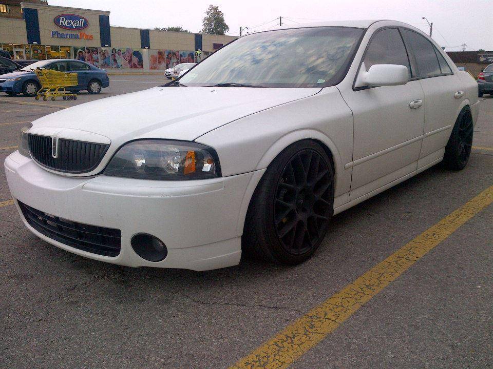

2002 Lincoln LS V8
Engine Specifications:
  • 3.9L V8
Engine Misc.:
  • K&N intake and filter
Fuel & Tuning:
  • Tune by SCT
Exhaust:
  • Exhaust delete (previously Magnaflow)
Drivetrain:
  • 5R55N automatic transmission with SST

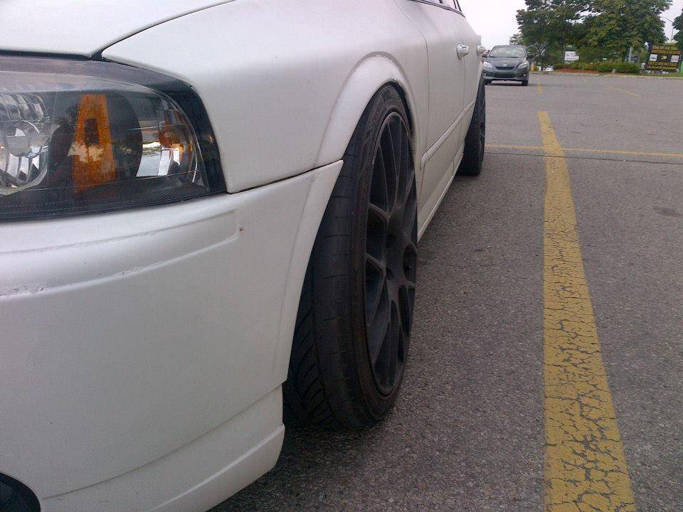

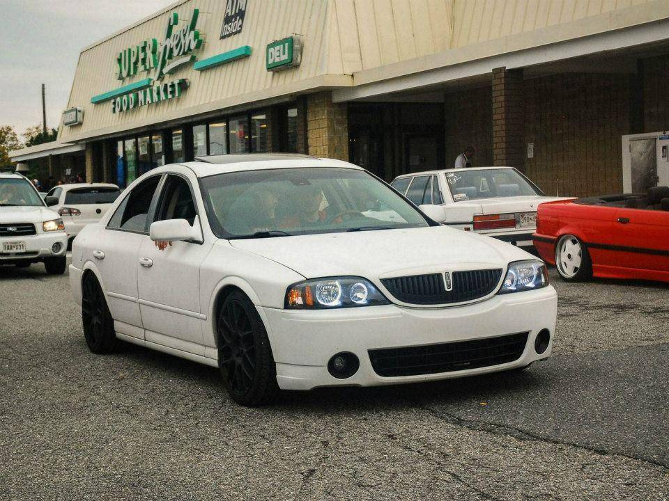

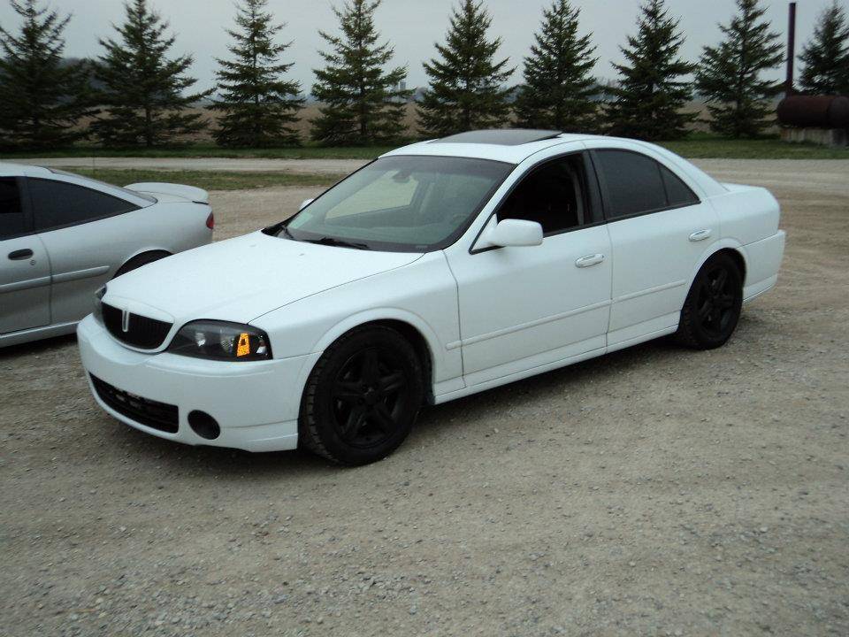

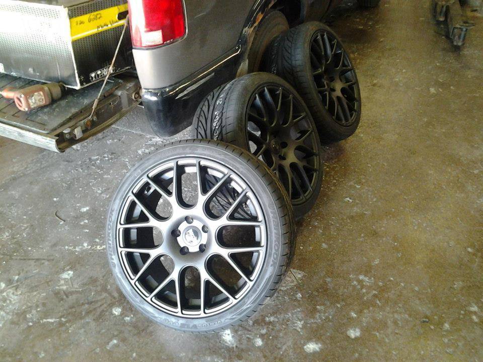

Suspension, wheels & tires:
  • Eibach springs. 1.5 coils cut front and 1 coil cut rear.
    Niche Circuit wheels in matte black
    Front: 19x8.5 et40 running 225/35 tires and a 36mm spacer
    Rear: 19x9.5 et48 running 255/35 tires and a 24mm spacer
Interior:
  • LED conversion

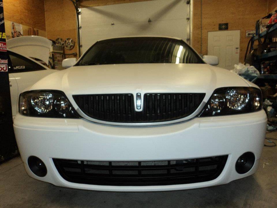

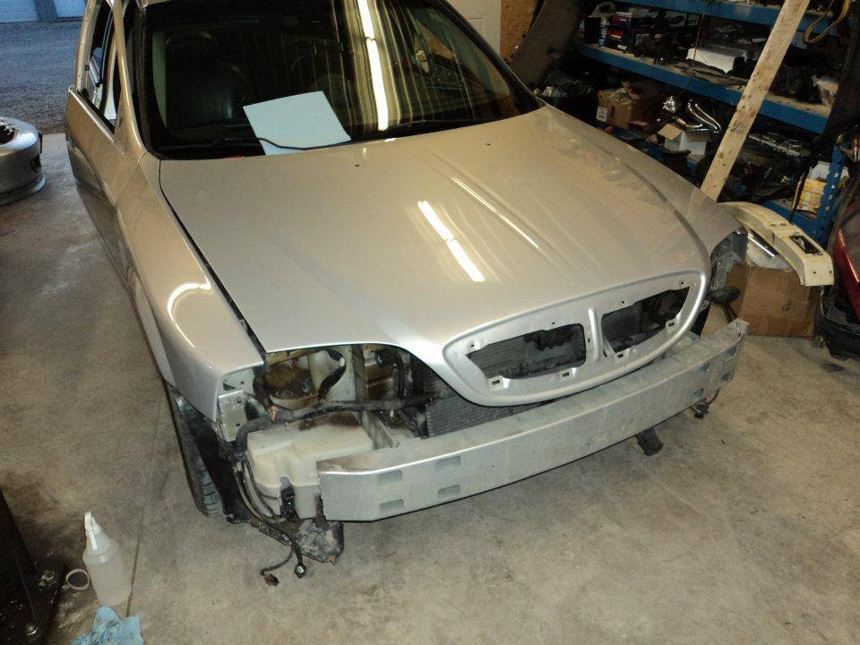

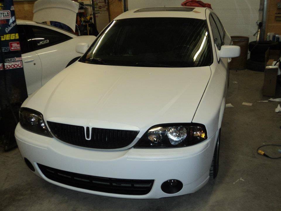

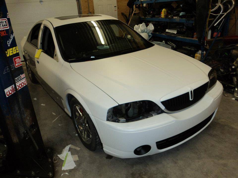

Exterior:
  • 2006 LSE front end conversion
    2003 OEM HID headlights
    3000k jet yellow Putco halogen fogs

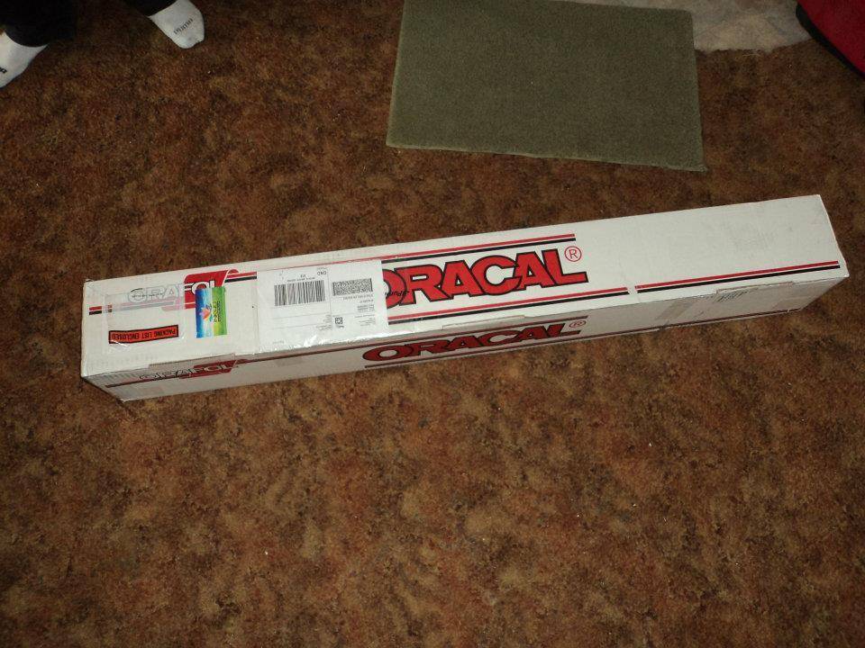

    Oracal 651 matte white wrap
