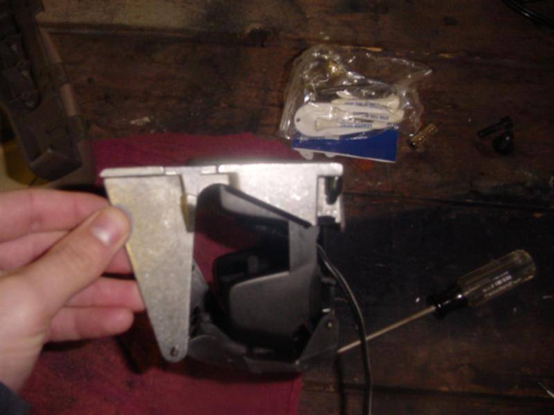

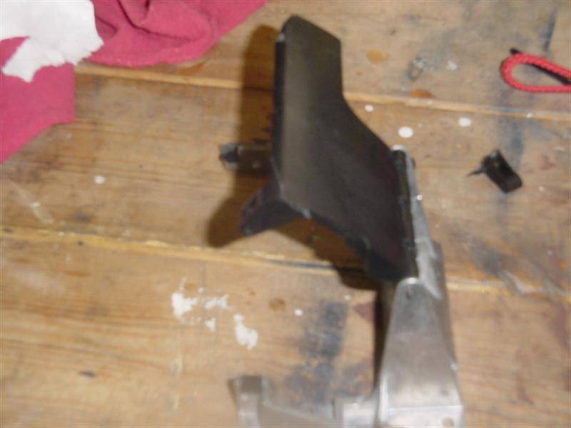

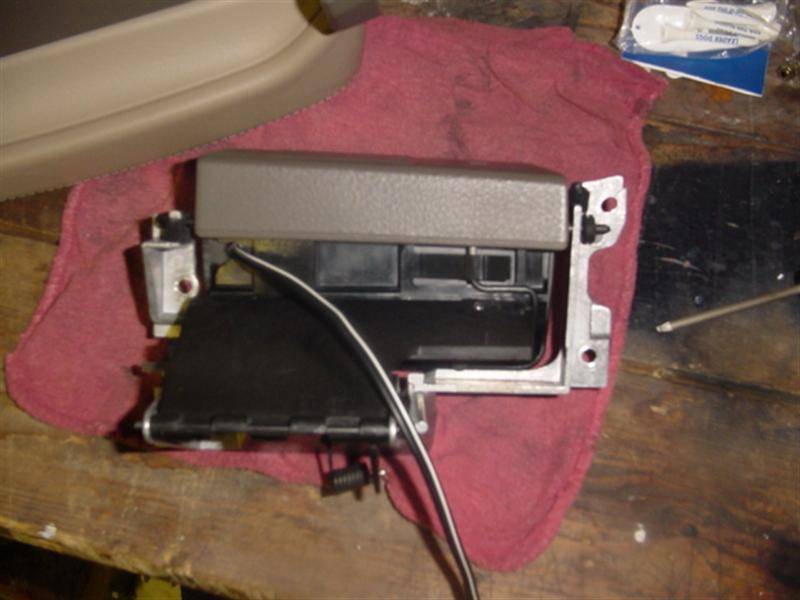

I believe your problem is a bracket which has a rod going through it connecting it to the cup holder, shown in picture one. The ends have broke off like one did with mine, you can see it in the picture laying beside the bracket.
I glued mine back on with a two part epoxy. I haven't had any problems since I glued it back together in January. Make sure you let it dry for at least a day other wise it won't work. I let my sit for about two days I think. If you want you could probably order a new one or find a used one on ebay with the holder still in it and switch it out.

When i got around to fixing it I noticed the spring had broke off the plastic on the end (what keeps it from closing up by itself) so I drilled another hole in the plastic and put the spring in that hole. Works great!
Nice and tight gives a nice little snap when i close it now. Nothing is moving it now. If it breaks again then i may look into an 2001 cupholder. But till then I am keeping mine. Its kinda nice being able to fold it away. when your not using it.
