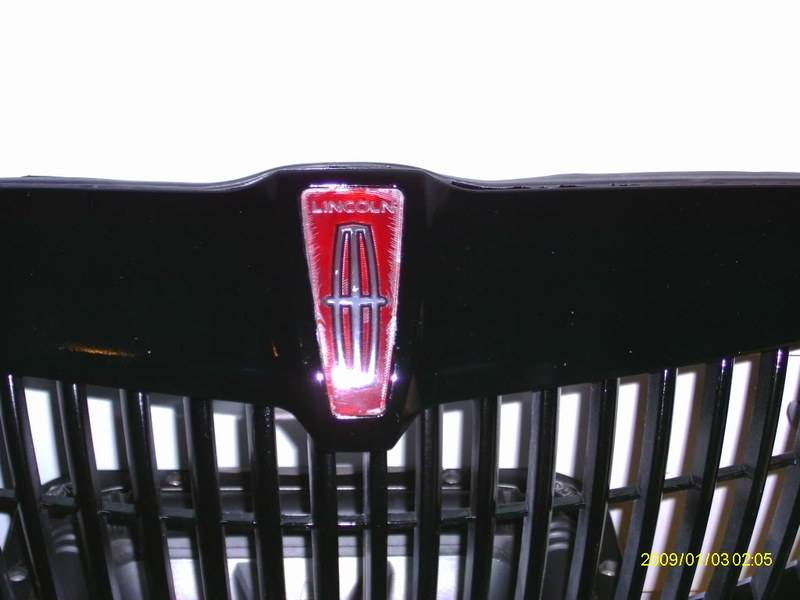

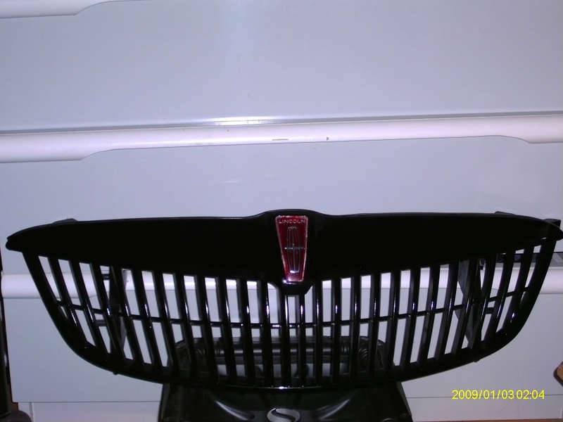

All done
That will look great on a black Continental- I can already picture blacked out windows and some chrome rims... Sweet!
Just finished this morning,I know you want to see it on the car,but I thought I'd give a nice close up before it goes on the conti to give you guys an idea.Hope this helps the people that ever wonder what it might be like to match the paint to their conti's.Let me know what you guys think.
looks good, can't wait to see it on the car!
Yea I want to see how long it will hold up before it chips.I did put the top header piece on since it's only a matter of 4 screws,but I'll be putting the bottom on this weekend.Check out my conti and how the top header piece looks.I put pics in the "age and year of your contiental" thread,mine is on page 5.
