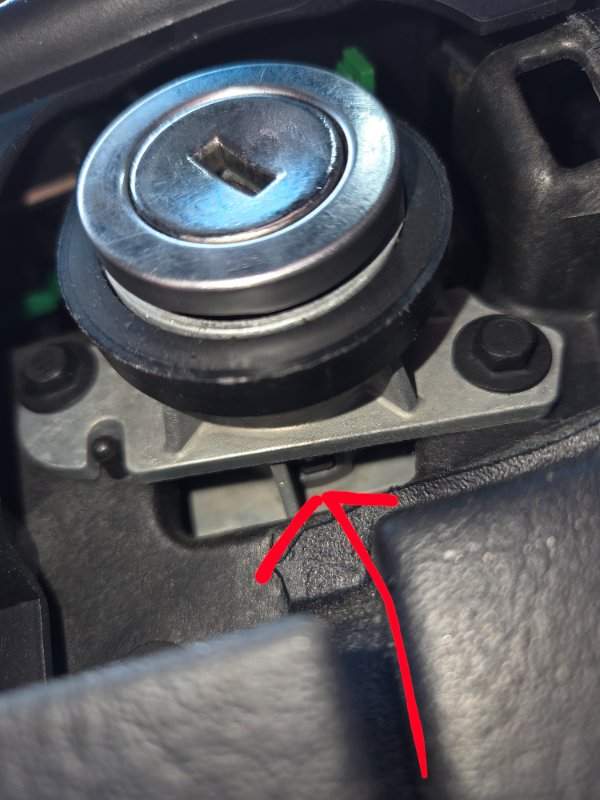

Still need to know... how do I get that cylinder out? I'd like to redo it now while I can.
well to remove you take the trim off and remove the (2?) bolts.. I dont remember anything complicated about the cylinder/housing... now to DISASSEMBLE the cylinder, thats another... not sure what you mean by "redo"
