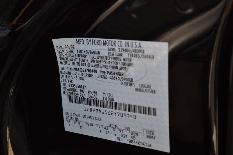

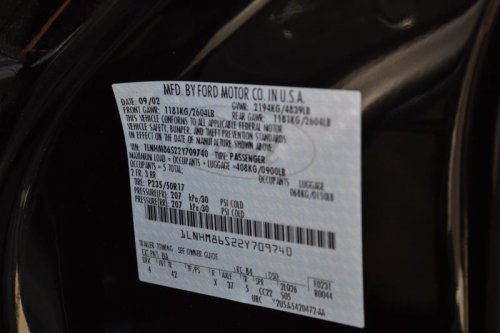

Here's the tag from the car. Tell me what you can about the car. I figure it's got to be one of the last manual LS's built in black since it's build date is 9/02.
(Thanks LS4me, I was looking for that post--still a rookie on this site) I have an excel file that shows your car listed. It's basically production numbers, trim and paint colors, not much else. The etis.ford site that LS4me has linked will give you the actual colors on your shocks from the factory. I will upload my excel file as soon as I can figure out why my upload is failing - I'll have to research that. It was an old excel file from around 2003 or 2004 that came from The Lincoln LS Owners Club (LLSOC) if I remember correctly. I'm not sure if they are still around, but they were an excellent source of info in the past.
Here's the info in the file, sorry about the formatting, I couldn't copy the columns directly beneath each other:
Model Year VIN Parsed VIN Audio Disk Desc Warranty Start Date (Orig) Trans- mission [TR] Tire Manufacturer [D3Y] Tire Size Sell Dealer Code Radio Desc Color Paint Color Trim Fleet / Non-Fleet Engine Calib Arrival Date Axle Ratio
2002 1LNHM86S22Y709740 1LNHM86 LESS AUDIO DISC PLAYER 3-Sep-02 C/R1 AC D3KJD 38460K CDX6 RADIO WITH 6 DISC CHANGER PNUAA 000ZU L 2LQ26S0A 4-Sep-02 EGACE
