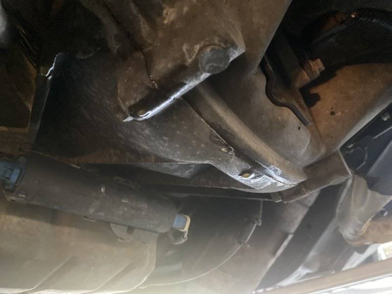

Hi, I drive a 2003 Lincoln LS with 90k miles. About a week ago I noticed it slowly leaking antifreeze. It is a very slow drip, maybe a drop every minute or so, but it accumulates over time into a decent puddle under the car. I took it to a shop and they bled the system and told me the leak had stopped, which it did. After about a day passed and I drove it twice, it started slowly leaking again.
Here is an image of where the leak is at, it seems to be running down the side of the engine from above somewhere, as you can see on the left.
It's hard to get under to see where it originates since everything is so tight together.
Any help or ideas would be appreciated
The leak is in the front under the hood on the passenger side, close to the middle of the car. Since getting it bled, it is leaking much slower so far and sometimes goes long periods of time without leaking much at all.

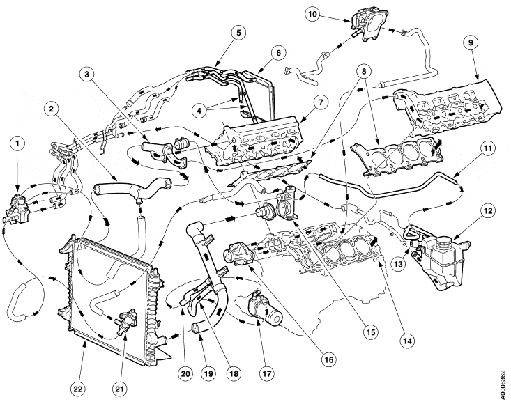

I thought you said you had a 2003?
That's the drawing for a 1st gen. Which is it?

Yes it is an 03, I have the wrong diagram there, and got it that makes sense that they rot from inside out.
So this is the 2nd gen diagram.
The overflow bottle is usually a primary suspect (12?), but since the leak is close to the passenger side I'd assusme it's something near there?

In the diagram... part #15 and part # 23 have O-rings that leak.
The engine coolant then runs under the intake manifold, and usually drips off the transmission bell housing.
You basically need to replace any/every plastic cooling system part on the engine.
Most OEM parts are obsolete now, so that means replacing them with aftermarket parts.

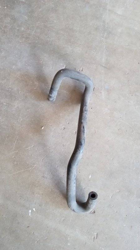

Another thing not mentioned is a coolant hose under intake at base of thermostat housing. It loops back to throttle body.
One end goes to a nipple behind the back of the T-stat gooseneck, and the other end goes to the throttle body.
Some people pull the intake to change that hose. Others don't pull the intake, but instead pull the throttle body through "creative methods". ... and special pliers.
I have done a few cooling system rebuilds. That hose doesn't seem to be a failure point since a cooling system rebuild is normally done every 70k miles. (at least when using factory parts).
Using aftermarket parts may not last as long.
I have a hose place that can replicate that hose... Using a steel middle section with 2 crimped stubby ends.
I have yet to contact them about this.

thats the ticket
I had coolant on the trans bell housing like this guy for a long time.
Then one day that hose blew.
