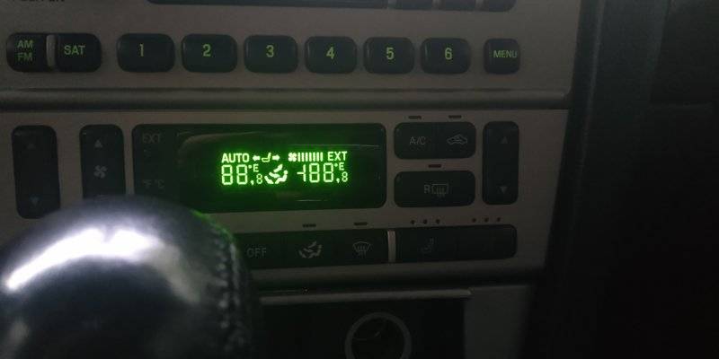

And yep indeed it was Fuse 1 under the hood on the passenger's side of the car. If it happens again then will have to dig into it with a paid shop. Also after clearing the codes after the fuse was replaced the one other code is now gone and now just the u1262 and p1000 (but p1000 expected since I cleared the codes out). And now if i run the test of the DATC I see the same thing from this post.
Problem with climate system
This is not my picture however it does the same exact thing.
Is this normal?
Yes, normal. That's what happens when there are no problems found. It's so you can verify that the display fully works.
