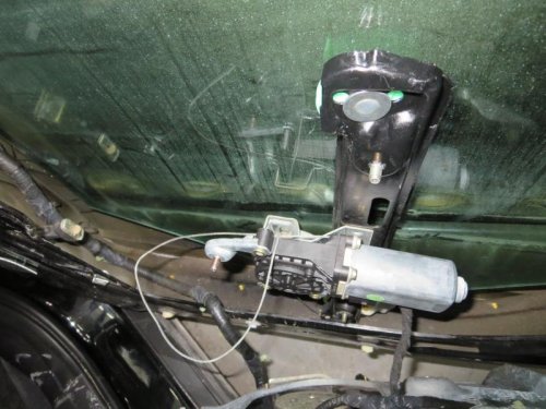

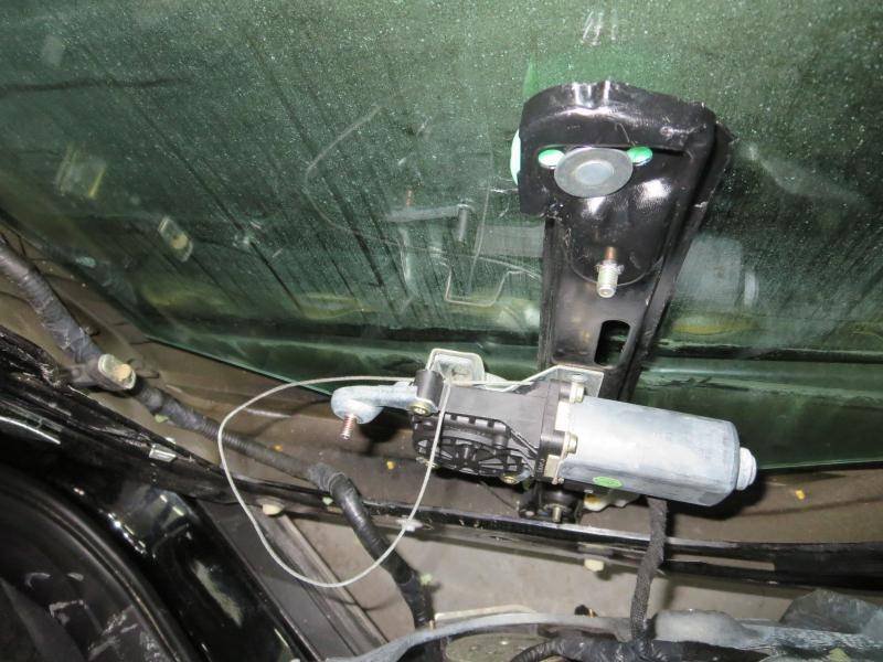

my rear passengers side window was going up and down very slowly making strange noises so i opened the door to see what the problem is the wire that goes around the green wheel was lose i tired to connect it back but it was too difficult because of the metal thats on top part of the green wheel
anyone know how to remove the regulator from the window it would be much easier once removed
i guess there was frozen water around the window and when i opened it it broke
there is an opening in the green wheel if you align it with the metal part the wire will fit through
i put it back together and heard the same crackling plastic noises window does go up and down slowly
there's a about a 3 seconde pause (motor spinning) when switching from up/down
i think one of the wires is no longer properly connected to the motor
i need to know how to take off the regulator white plastic piece off the window for closer inspection anyone??
To get the glass out, pry out the center pin in your picture above.
The wire (it's one wire that loops all the way back to the regulator spool) is still connected at both ends. The problem is that at least one loop of the wire came unspooled. (The wire wraps around the spool several times.) Unfortunately, the wire often gets chewed up and does other damage when this happens. You can spend some time and grief trying to get it correctly respooled, but you may find that you still need to replace the regulator.

removed regulator from glass opened it everything looked alright except for the wire was really messed bent twisted no way i can respool it i'll have to get a new reg

The window regulators break because the rubber window seals bond to the glass over time. Then the motor pulls too hard and the white plastic parts break.
Cycling the windows now and again can help. You might notice that when using a window that does not get much use it's very common to get a loud "pop" when the window first starts to move. This it what slowly cracks the white plastic pieces. I have always found multiple bits of plastic in the bottom of the door where they come apart piece by piece.
Also remember if you only replace the regulator (because the motor almost never goes out) that you must clock the motor to the regulator or the window won't go up and down correctly. After fighting this I now get the entire regular/motor assembly as it's a pretty quick repair if the whole thing is just swapped out.
The plastic piece was replaced with metal in later revisions. The failures were almost exclusively confied to high heat regions; mainly the southern tier. Lack of use exasperated the problem. The associated TSB called for replacement of both regulators when one failed.
