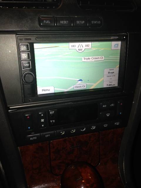

Guy I appreciate all your help but.... I'm very much understand about the Double Din change and advantages. I have one in my 02! Its a Rosen Carshow Navi, one of the best units out there, with Soundstream amps, and more. Changed out all the door speakers, Trunk Sub, the full works.
Trying not to go that route again:(
Like this one in my 02?
