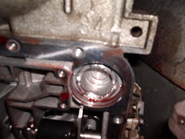

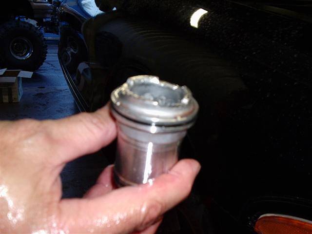

some people like the smooth but present feel.the reason for the repair is so the piston bore dosnt get to scorn ,then have to sleeve it or replace the case.it is defanitly a must do with shiftkits or without. bypassing 1-2 will send the trans to an early grave. :give

This is what happened to my piston when I discovered it that was the least of my problems.
