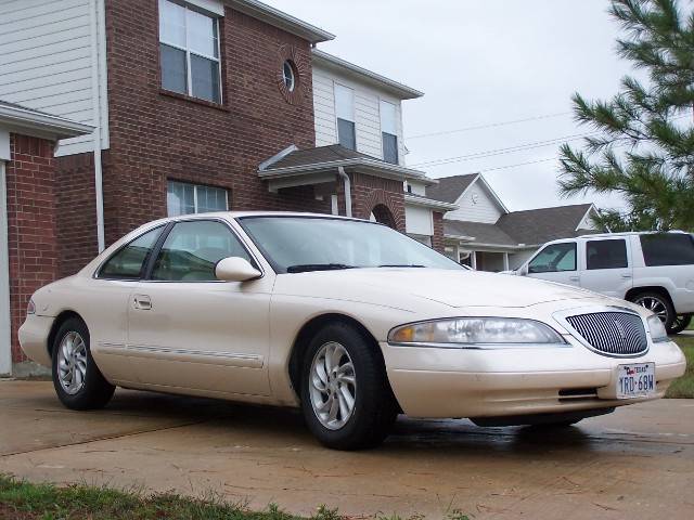

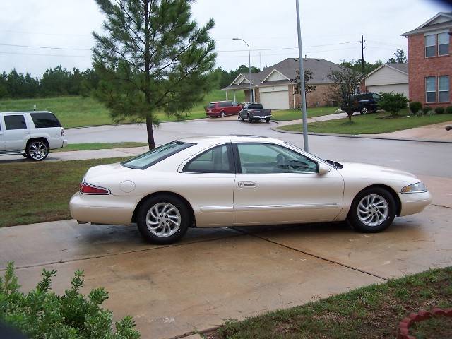

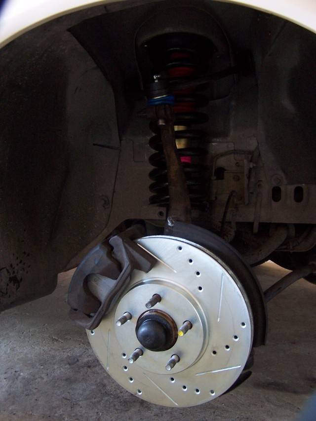

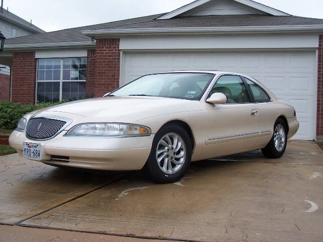

Saturday, with the help of my buddy, I replaced the air bag system on my 97 with springs I got from Eddie at American Air. The job was long and hard and it took me from 10am until 8pm stopping for breaks twice. Not only did I do the springs, but I also changed the upper and lower control arms and the sway bar links. The all needed it. I didn't stop there. I also changed the rotors and put in new brakes.:eek:

how much did those rotors set you back? nice job on the drop
Looks good :D The height is much better!! I don't know why the 97 -98's look like they sit so high in the front !!

G! That is sweet! You Go Hottie!! Those rotors look like mine - who made em and how much? Looks nice babe!!!

Did the alignment first thing this morning. All is good :cool:
MsM8
Deb, Thanks for the compliment. I got the Rotors from RC1 Concepts out of California. They cost $135 for the set. Glad to see that you're ok and feeling better. Missed you around here.:)
I got a set from RC1 Concepts also for my 93 they've been holding up nicely.
