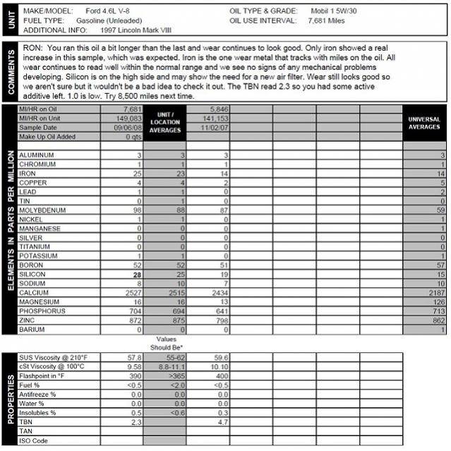

The next time you change the oil, take a sample and have it analyzed by Blackstone Labs. The report they provide will tell you everything you need to know about the condition of the oil, as well as the the wear of the metals inside the engine.
http://www.blackstone-labs.com/
I've had oil analysis done on two of my Mark VIII's and on my mini-van. I use Mobil-1 5W-30 exclusively. On my 97, they recommended trying an 8500 mile oil change, as the oil still had active additives after 7600+ miles.
Here's the report they provided for my 97 after analyzing two samples.
Since I take care of 6 cars, it got to be too much of a PITA to remember which car needed a change at what mileage, so I just use the oil change meter built into the Mark VIII's. However, it's good to know that there's still life left in the oil, even when the meter tells me I need to change the oil.
Hmmm. Interesting. I may have to do that. I've noticed on both my Marks that when I change the oil, it always comes out black. Even changing oil and filter every 3K miles. I may just have to send a sample out for analysis. I may learn something about my engine that I didn't know. Thanks for the info.
