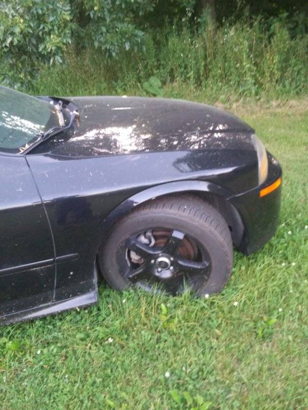

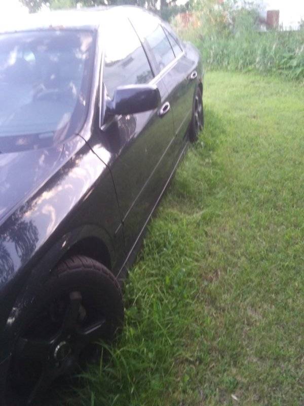

I will finally be the proud owner of the rare and elusive 2002 LSE in a couple weeks for $700 just waiting for the guy to get the title in the mail...question ???? The car has a broken moon roof when you close the driver or passenger door you can see it raise up of the top of the car ...does anyone know if this is a quick fix ....I tried using it and it does go back about 6 inches then stops ...will this be a easy fix or will I need to grab one off a different LS? The next issue is no reverse? Any thoughts on whether it may be a solenoid? Or will this be a complete rebuild? All other gears work great...and yes that is correct 123,563 miles

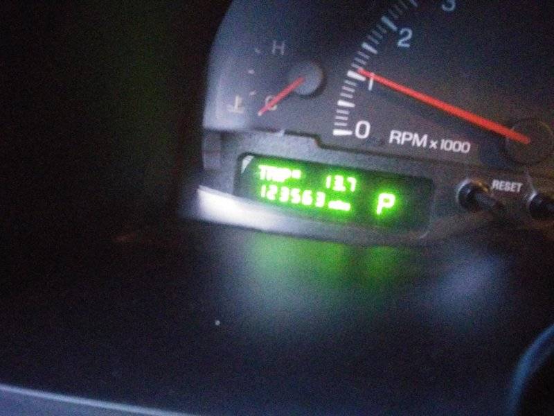

I will finally be the proud owner of the rare and elusive 2002 LSE in a couple weeks for $700 just waiting for the guy to get the title in the mail...question ???? The car has a broken moon roof when you close the driver or passenger door you can see it raise up of the top of the car ...does anyone know if this is a quick fix ....I tried using it and it does go back about 6 inches then stops ...will this be a easy fix or will I need to grab one off a different LS? The next issue is no reverse? Any thoughts on whether it may be a solenoid? Or will this be a complete rebuild? All other gears work great...and yes that is correct 123,563 milesView attachment 828572446 View attachment 828572447 View attachment 828572448 View attachment 828572449 View attachment 828572450 View attachment 828572451 View attachment 828572452 View attachment 828572453

Well whatever the case may be ...like I told Dale even if I bring it to my Mechanic and he sends it out to his transmission guys, I only paid $700 for a Black on Black LSE :D
I saw the ad on Craigslist it was just for the aftermarket wheels and BF GoodWrench Tires with less than 300 miles on them and I thought I would ask if he still had the Lincoln ...he said yes and that because the reverse went out I could take the car and all for $700 ...after he sent me the pics I requested I was over joyed to see it was a LSE lol :D
