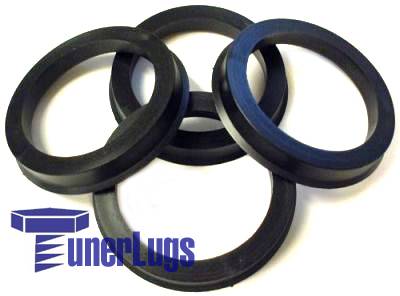

Maybe you need hub centric rings? I had that problem on my BMW, but I got those rings and the problem went away. I have em on my LS too, I do not have any shaking problems.
The place where I bought the rims from, that guy had em ordered for me and he checked the exact sizes from D'vinci co. and he had em made somewhere. I am not familiar about the size, but I think you can have on of the rims shops look up for you in their books.
The ones I have are made from copper and made a real nice difference, now my steering wheel doesn't shake at all.

Hey hyelife what size did you buy them? I bought some for mine but seemed a little loose on the inner diameter.
