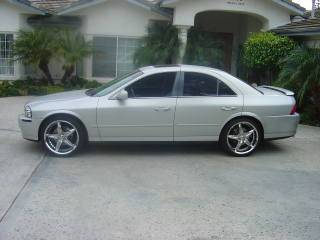

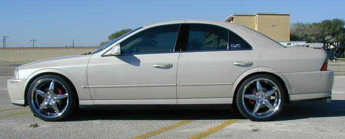

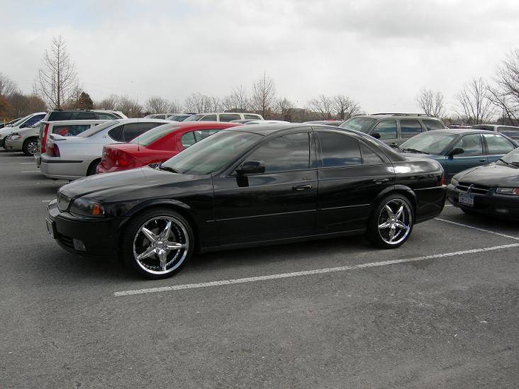

If you dont want the wheels to stick out, and dont want to spend alot of money, get wheels with an offset of 45mm+ and you should be alright with your lowered ride....although you could spend like $3k-$5k in custom wheels for a perfect fit (Asanti, HRE). I had 20" antera 309's with a 45 offset and were a perfect fit for the LS in my opinion absolutely no rubbing, but I recently bent two of them, and bought a cheap set of replacement wheels with a 35mm offset and the difference is huge... the new wheels are rubbing a bit and it sucks!!!.. Im going back to the anteras soon after I fix them.
Lowered on 20" x 8.5" Foose speedsters, +45mm offset, 245/35/20 Nitto 555.
A little rubbing when the car was loaded down with 4 adults and a baby (only over big bumps).
Man those look familiar.....
Same set of wheels and tires(literally) non-lowered and no problems rubbing.

WOW nice wheels boyz..... mine is not lowerd and has 255 35 20's
