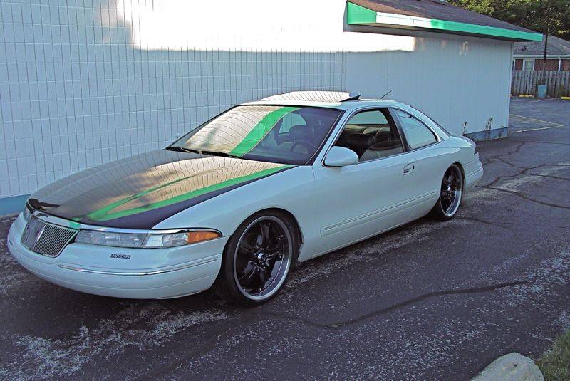

20s. Could have used more meat on the tires, but no issues with rubbing, etc. And the ride was rather nice.
damn those are nice rims. oh and a nice mark.
Thanks. Not sure what ever happened to the rims. The Mark, though, crushed at a yard in Chicago just before the engine was rescued by someone.

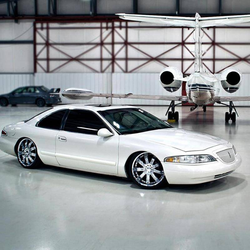

this is my 97, still has stock air ride but its turned off. they are 20x8's with a 225/35 tire. no rubbing, i drive it daily just like this.
yup. do you feel like you are driving a dump truck?
cuz you are just bouncing off the bump stops all the time.
if you say otherwise, well, i just don't believe you.
