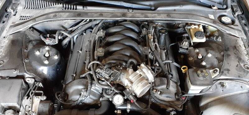

Bought an LS with motor seized up. Was hoping someone could give me advice on what I should replace while motor is out. I know I should replace everything but I'm not putting thousands into it at this point. Just want to replace the hard to get to things while motor in. So far on my list is cooling system.
How long was it sitting with the blown engine?
A little prior planning would prevent some of this grief you're experiencing. So a good used motor under 100k about 800-1000. Got mine at 89k 850. And since you got it out, power spray the engine bay, all new radiator hoses, water pump, front & rear main seals, send one set of injectors out for cleaning, and dont forget CRC connector cleaner several cans. Reseat with plenty of Permatex 650°F silicone of the oil dip stick tube, a major leaker. And over time the thin sheet metal exhaust gaskets leak a small amount of gas and harden the valve cover gaskets so, reset them with yes Permatex 650°F silicone. And if you snap off a stud, a relative easy fix out of the bay otherwise a super pain in the _ _ _. Motor mounts, power steering pump, alternator, & auxiliary water pump should have some attention. These are some of the tasks I did last year chasing the maintenance and replacing the complete AC sys on my 470k motor.
I would allocate two months of weekends to address most of the work while your save your money. Get the OEM service manual from Helms publishing.
About a year. Found a motor with 65k miles. LS had 93k. Car was kept real clean. Thermostat housing went on it and wasn't replaced properly so the car was driven with overheating issues too long an blew motor. Other than that, I believe all else was workin properly.
