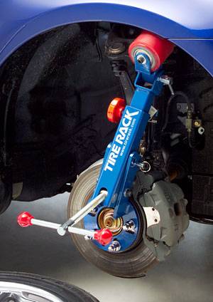

Simply put, the inner lip of the fender is "rolled" or actually pressed inwards, away from the center of the hub and towards the actual fender. This will give you a little extra room for the wheel to travel. Usually, a device is installed on the hub and pressure is exerted onto an arm with a roller attached that rolls the fender lip. Or, you can have at it with a wooden mallet and do it yourself. Do it right and it will solve the issue; do it wrong and you'll damage the fender. Not sure where you can get it done professionally... maybe an auto customizing shop; I don't think auto body shops usually cary this stuff:

That's a pretty sweet setup there. Does Tirerack.com sell that? I need to do that to my car in the rear. The front is fine. The only problem up front is the plastic under lining. It shows where it rubs the most and I can take care of that by pinning it back a little. However, the rear rubs on the inside of the fender lip.
Thanks for the pic Mike!
EDIT: Tirerack.com sells the fender lip rolling tool for $299. Not a bad price if you want it done right. Buy it and then do all your buddies cars for a fee and you can pay for that thing in no time. Also, it looks like they have some nice torque wrenchs. Here's the link to the lip rolling tool:
http://www.tirerack.com/accessories/tools/fenderlip.jsp
