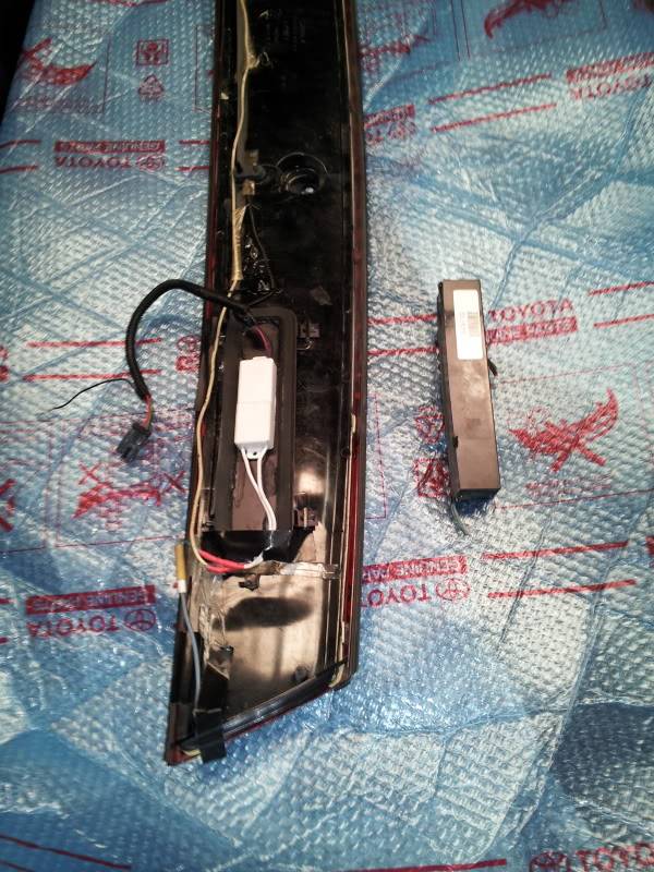

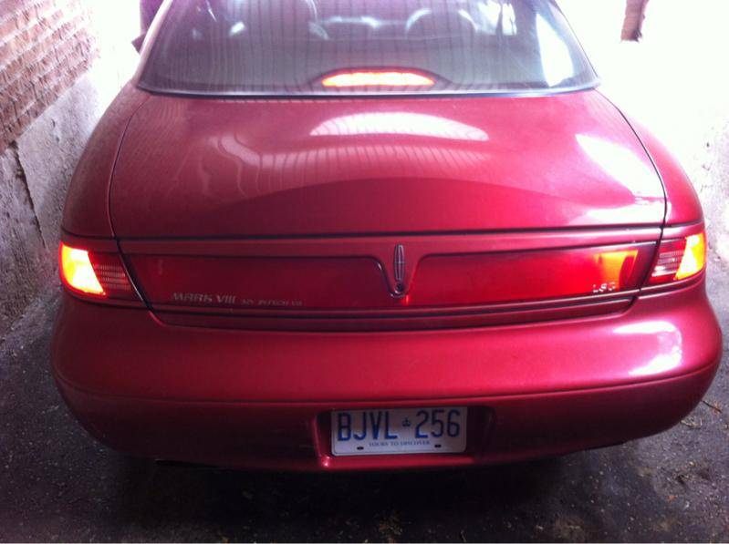

I have a 98 LSC and the rear neon does not currently work, however if I unplug and plug it back in at the ballast it will flicker for a second. Does this mean my ballast is junk or is there a way to repair this. Would prefer to not have to buy a replacement would rather fix if possible.

You may have humidity in the actual ballast. Pull it out & let it air dry for a full day. Plug it back in. If it works, then pull it back out & seal it with silicone all around. If it doesn't, toss it, time for a glitch ballast.

If your neon flickers.. your ballast is dead, buy a Glitch Ballast and be done..

There's a slight weight and size difference between a stock ballast and the Glitch.. the Glitch is the white one

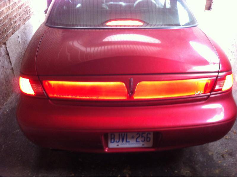

Mine did exactly what yours is doing. Just a quick flash and nothing. Installed new ballast and AWESOME
If you've never pulled your neon.. go to Walmart and get some super glue and some tape. You'll more than likely need to reglue at least 1 mount, use tape to hold it on til glue cures :)
