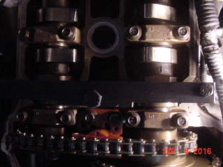

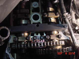

Ordered this from Amazon for my 01 V8. OTC cam tool set. If I install the tool with the center hole lined up with the threaded hole in the block, the tool sits on top of the cam shoulder and doesn't sit on the flats. If I reverse the tool it will sit on the flats but I can't install the center bolt. Has anyone else used this from Amazon with this result? DSC00038.JPGDSC00039.JPGDSC00040.JPG
Disclaimer: I haven't tried this.
The service manual drawings show the tool installed the way you have it in the top picture, without the center bolt used.
That's the way I decided I would have to use it even tho the pictures that came with it showed all three bolts in place. Does the service manual show which type of crankshaft pulley puller to use- 3 jaw gripping the outside of pulley or type with two bolts in the damper its
elf. If one should use the two bolt type, does it show the size of the bolts? Again, thanks for all the help Joe. Found the answer- uses the two bolt puller. Thanks anyway.
