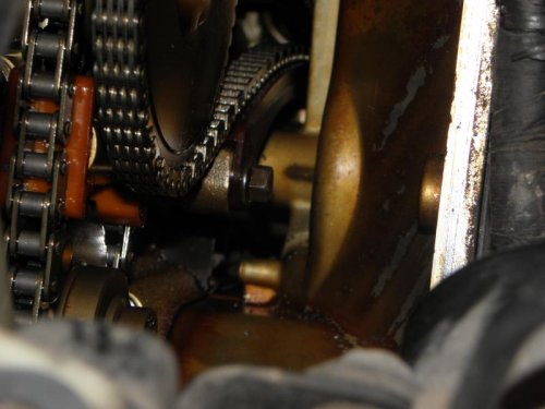

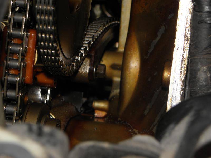

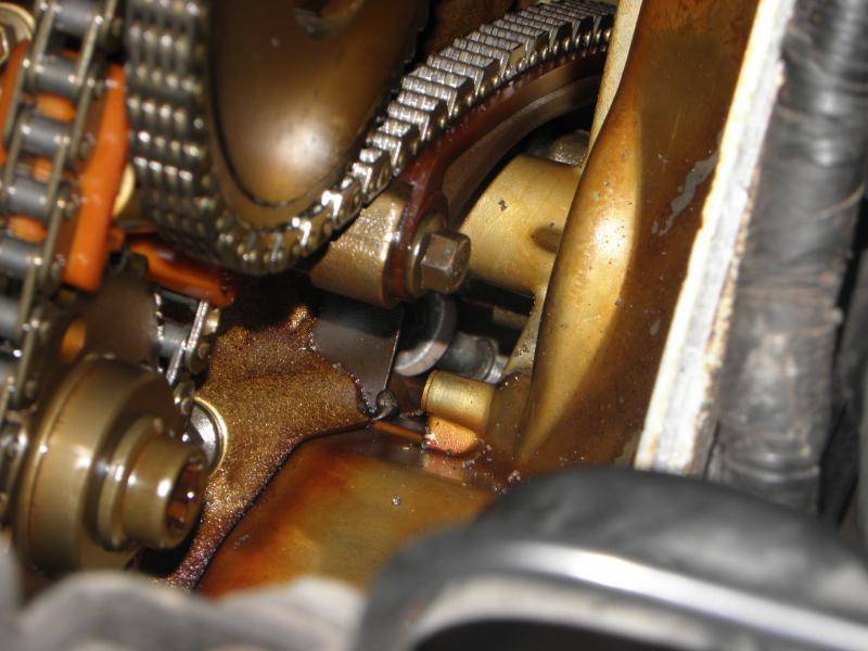

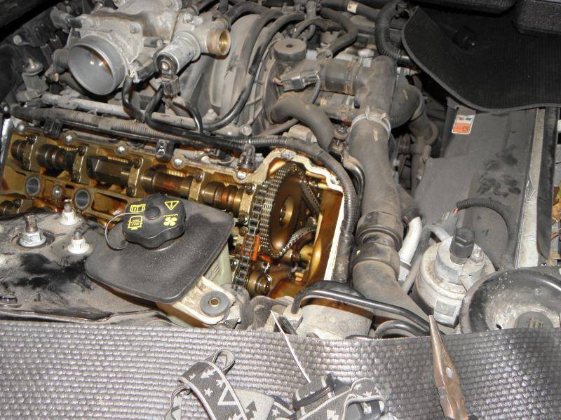

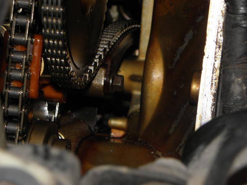

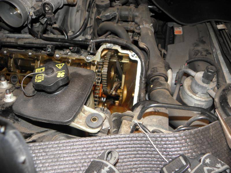

I was hoping my 02 squeaked by with the upgraded tensioners. The car was built 7/02 IIRC, but I looked back at pictures I took when I dropped a valve cover bolt down the chain opening, and...
That looks a lot like a red plastic tensioner... I think the car's gonna be down for the count for a while :(
Looks like September was the [fuzzy] cutoff for the updated parts
