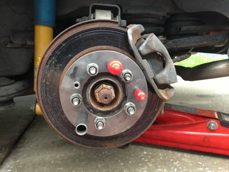

this are my redrilled mark viii rear hubs.
it is all flat, with plenty of extra radius. so you can go a little bigger and not ruin anything.

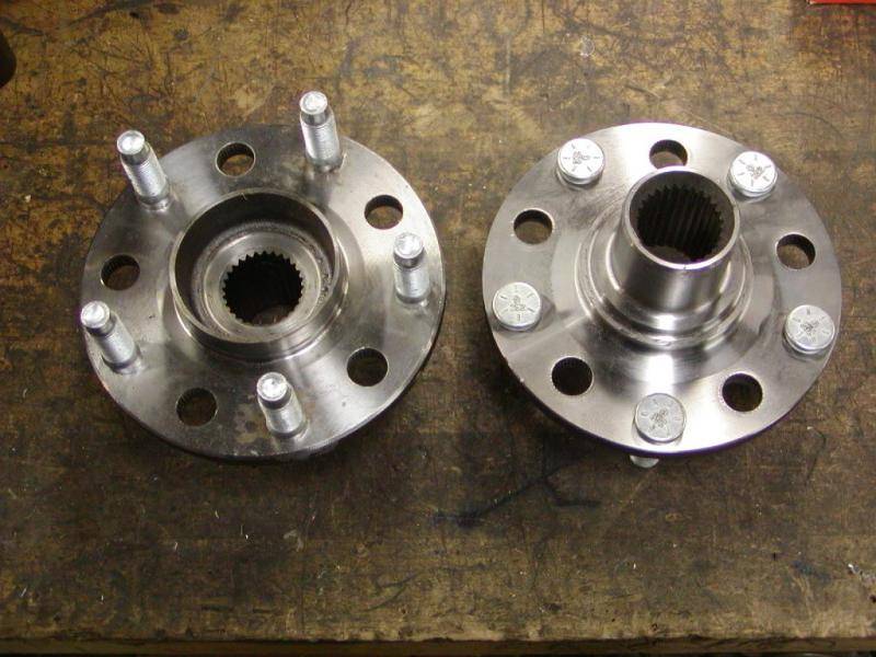

also of note, most (every one i have seen) mark viii front hubs look like this. the manufacturers have removed metal where there are no studs. so you can't drill there because you just don't have the supporting metal.
we also got lucky, as the 99-04 cobra mustang with IRS shares many parts with our IRS, the wheel hubs and bearings interchange, front and rear.

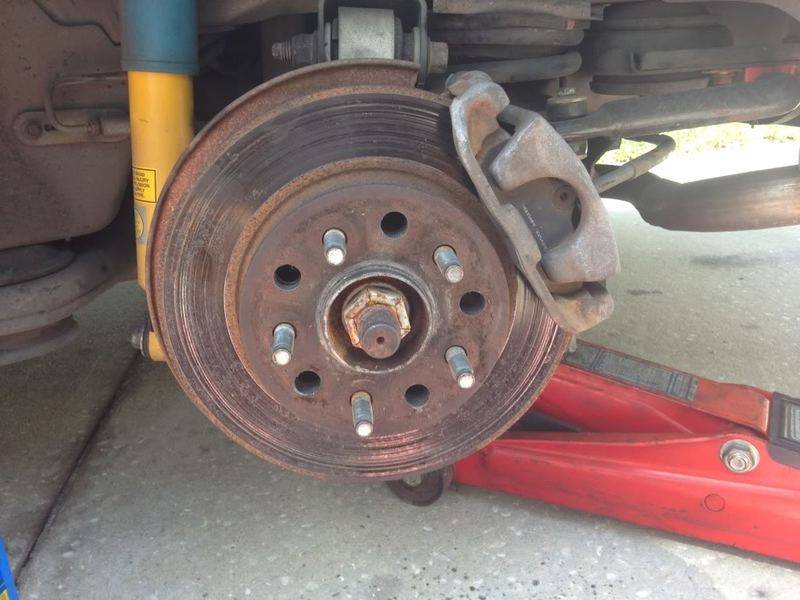

now this is an LS front hub.
the edge is tapered, with the studs are being pretty close to that taper. move the studs closer to the taper, and you might compromise the strength of the hub.
now, are all LS hubs tapered? do some have the full flat metal plate? maybe one manufacturer and not another? no idea. someone would have to do some leg work, pulling and measuring the hubs to be sure. but it certainly throws a curveball into the mix.

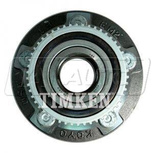

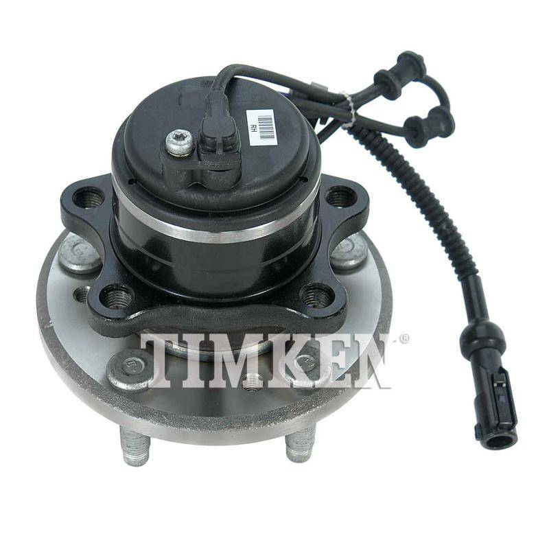

i have tried to pull timken/koyo pictures because i know Ford likes to use them as original equipment.
Hmm, so it is doable as long as the structural integrity isn't compromised. I wonder about the Jag S-type hubs. This has got my gears turning, and if I could redrill, that would save me some money in the long run, and make my wheel selection open up by a vast margin.
