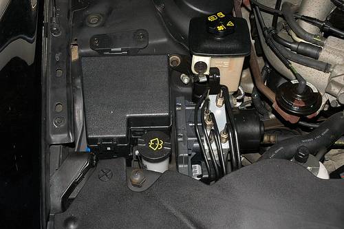

Just to be crystal clear, the reservoir we're talking about here is on the passenger-side of the engine compartment near the strut mount. It has a fan symbol on the cap. I did siphon out what I could from the reservoir and replace it with fresh fluid, but it didn't seem to have any effect on the fan speed.

To begin the mod, I removed the black plastic radiator cover, and the smaller plastic cover in front of the hood latch mechanism. Right away I noticed lots of leaves and trash stuck in front of the radiator so I cleaned it out as best I could. I thought cleaning out the leaves alone may be enough to fix it, but it still overheated.

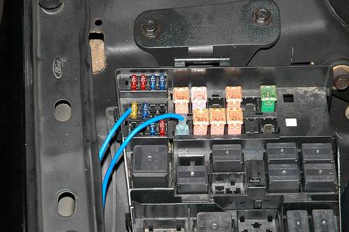

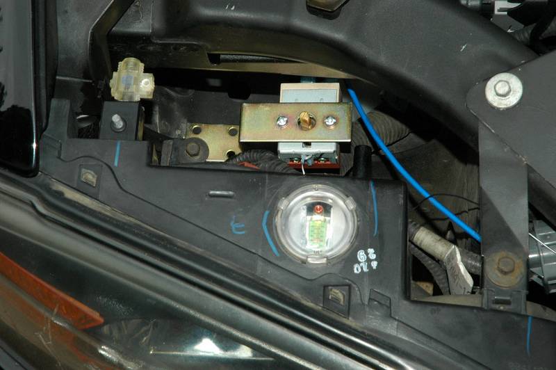

I used the relay box located conveniently behind the pass. headlight. Took power from the 20A fuse. Power is only supplied with key in "run" position:
Here you see how I installed the thermostatic controller using an existing bolt (I know - the blue wire looks like cr*p):

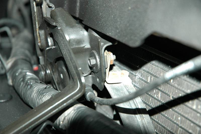

Here is the way I used an existing bolt behind the hood latch to secure the fan:

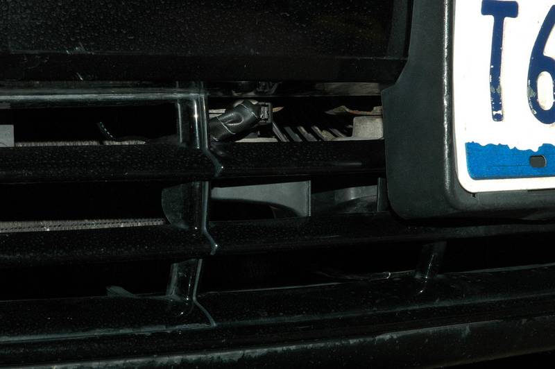

Here's a look at the installed fan from the lower front:

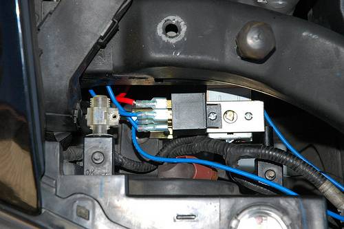

Ok, here's the revised installation. Bought an 12v auto relay from Radio Shack p/n 275-226 ($6.99). Bought an in-line fuse holder p/n 270-1217 ($2.99). So a whopping $10 more invested on top of the original $47.
The parts:

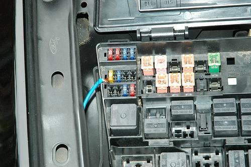

The relay allows me to draw 12v from an unused section of the relay box, and to have the 12v switch on and off with the ignition. The unused section is hot all the time, even with the ign. off, so I needed to connect the switch in the relay to something that is only hot with the key turned on.
All the fuses in the relay box are hot only with the key on, so thats where I connected the switch. Understand that the 20 amp fuse I connected the relay to is NOT powering the electric fan. It only powers a micro switch that opens and closes the circuit powering the fan.
I needed to add a fuse, so I added the in-line fuse between the power connection at the unused relay section and the thermostatic fan controller.
Here's what it looks like:
I mounted the relay using an available screw on the thermostatic controller:
And here is the finished installation:
The only thing I would change is the color of the wiring to black, but the way I routed the wires you don't really see them anyway.
