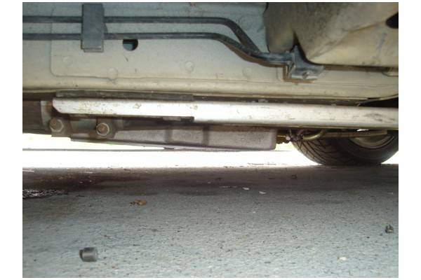

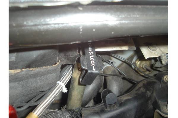

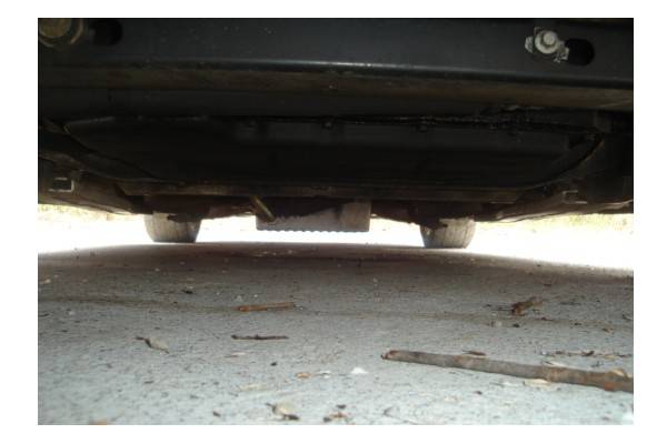

I actually just recently purchased a deep sump trans pan with dipstick for my 00 ls...the dipstick tube needed to be bent in a few places but other then that its a pretty clean install..and just so you know it does sit about 3/4 of an inch below the frame rails...so YES its low, especially with my eibachs...i will take some pics when i have some free time..

Here's Some Pics...
Yea it is EXTREMLY low..but its not my everyday driver so i dont mind....i must say that speed bumps are almost imposible....lol....god i hate those :slam
I concur, I could never drive with that trany pan installed on my LS. I would worry everytime I drove on the LA's freeways!
Here is the problem with running that hi-cap oil pan on the LS. Its overall goal is to lower trans temps by offering more fluid to help lubricate and cool the transmission. But by installing that low hanging pan it significantly raises the chance of banging it on something and causing a bad leak. Transmissions with low to no fluid do not work too well.
