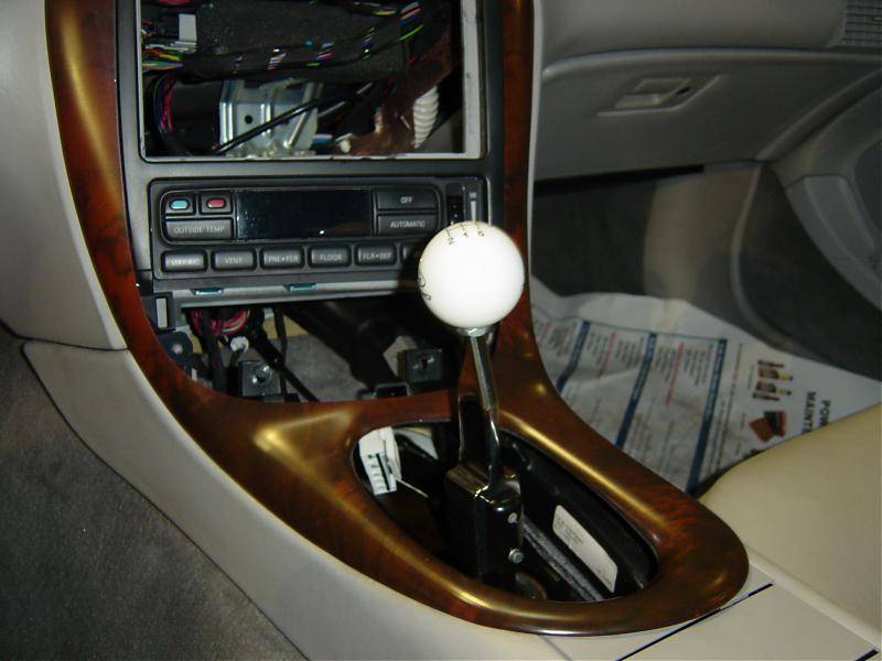

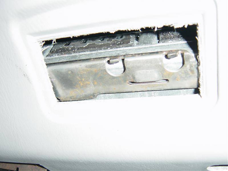

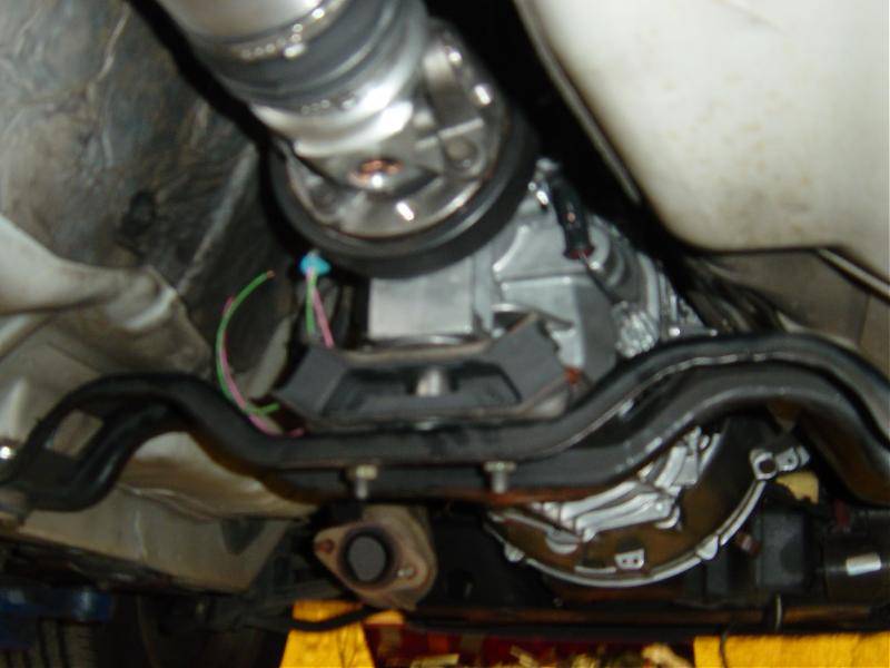

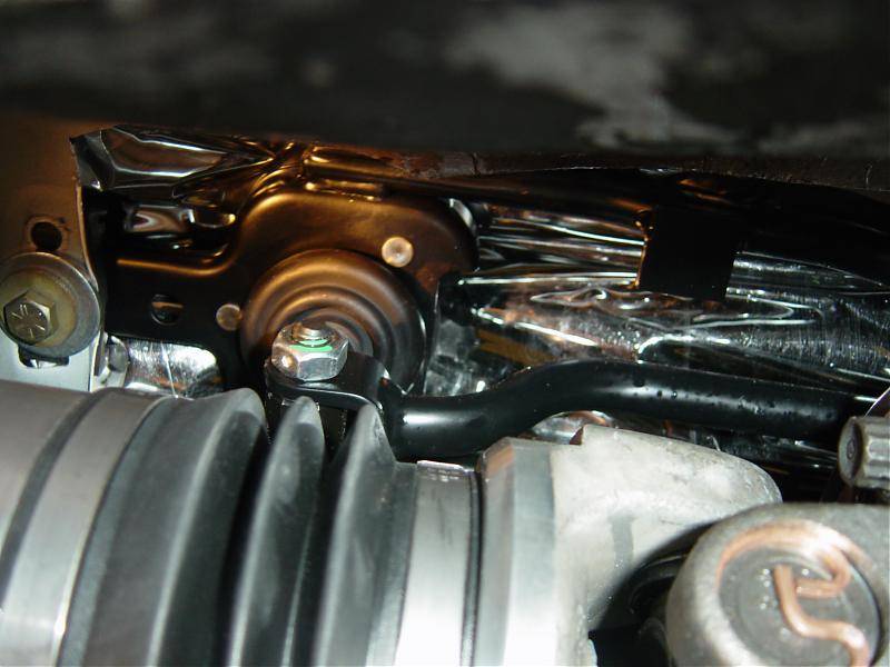

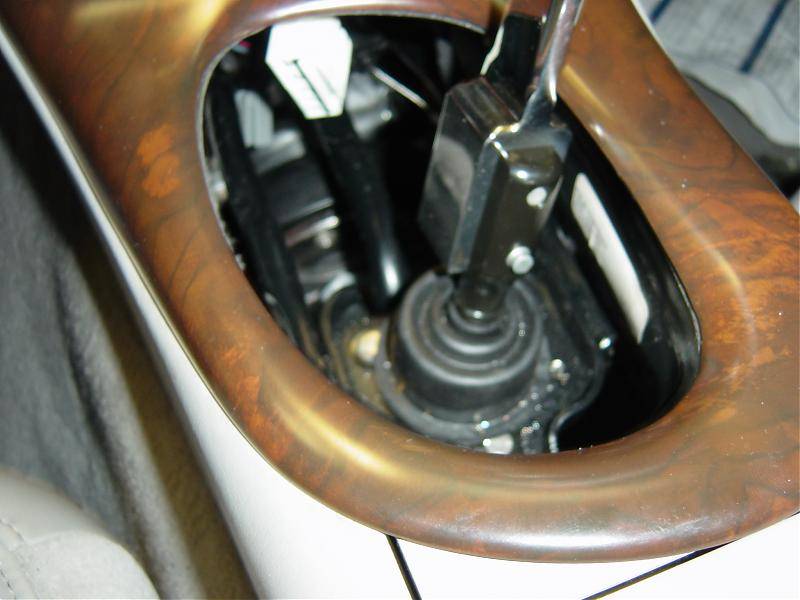

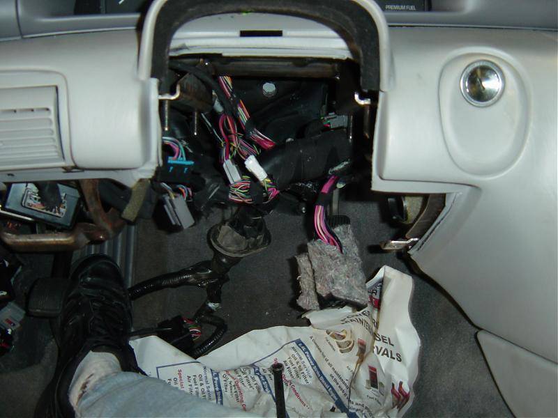

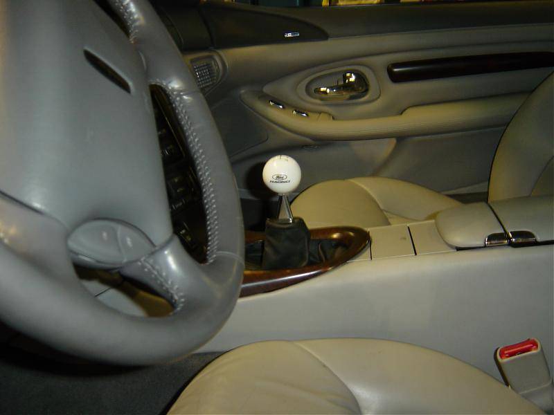

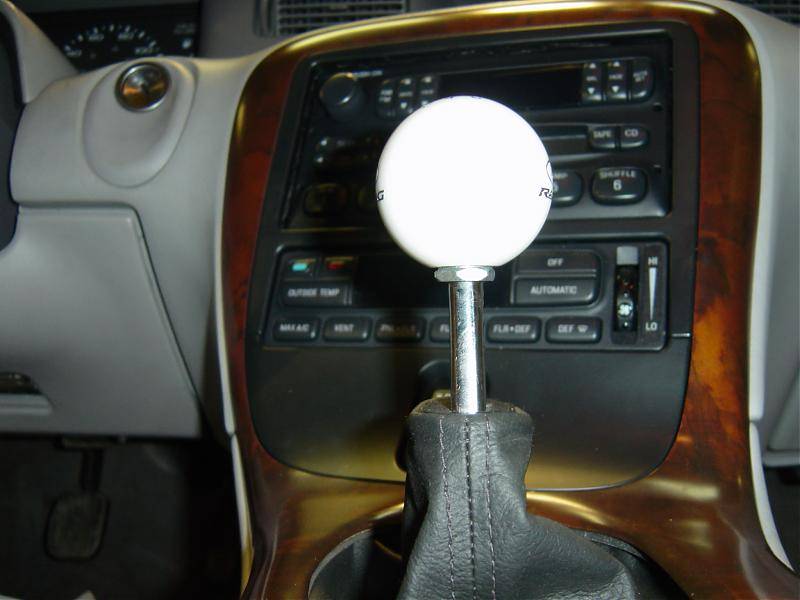

I'm installing a 6o6o in my Mark. The reason for this transmission choice was the shift posistion and 50 6th gear. We had a custom drive shaft mfg. for it, and are using a Shelby shift linkage. It looks like we may be able to reinstall the PCM back under the Dash. (hope so). Used a Supercoupe clutch pedal asy they are getting hard to find. We may have gotten the last new master cyl. left. The install is being done be Jason at Legend Mustangs, He's doing a first class job.

Looking good so far I really want a six speed but don't have the money or the know how to tackle such a task. I also don't trust anyone in my area to do it. But keep the pics coming and is the car n/a or supercharged.
So no modification to the shifter location? Thats where it bolted up to?

Ok. Drove the Mark this morning. we still were getting rid of nusanice codes, got rid of the traction code problem, so you don't have to turn it off every time you start it up. also gear selector msg. is now gone. The car is a real pleasure to drive. i'm gonna love it even more. The PCM is located under the dash had to elimanate the whopee vent, I didn't use it anyway. If anyone has this swap in mind, you better start looking for the super coupe pedals.

not really...............The 6060 Has a remote mount shifter linkage fromt he factory.
Makes it alot eaiser to fab in to the VIII.
