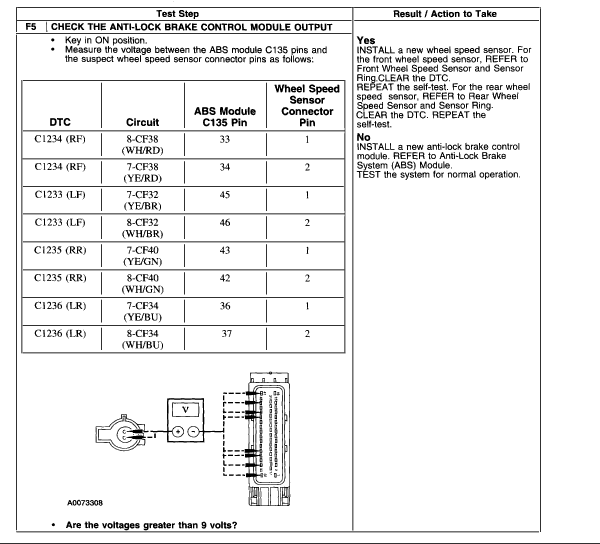

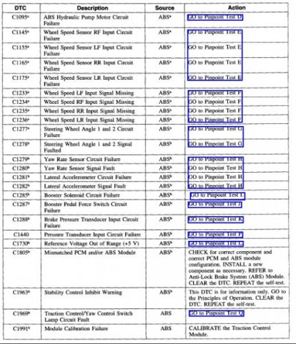

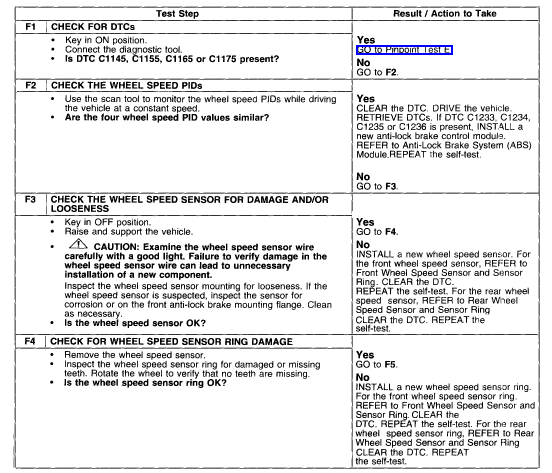

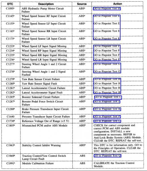

C1236 code ...........
Normal Operation
The wheel speed sensor and sensor ring generate a square wave signal to the ABS module that is proportional to wheel speed. The ABS module compares wheel speed inputs from all wheel speed sensors to determine an impending wheel lockup.
Possible Causes
Mismatched tire sizes.
Wheel speed sensor ring.
Wheel speed sensor.
ABS module.
