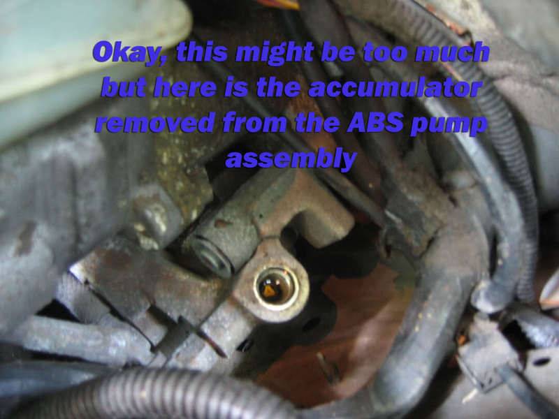

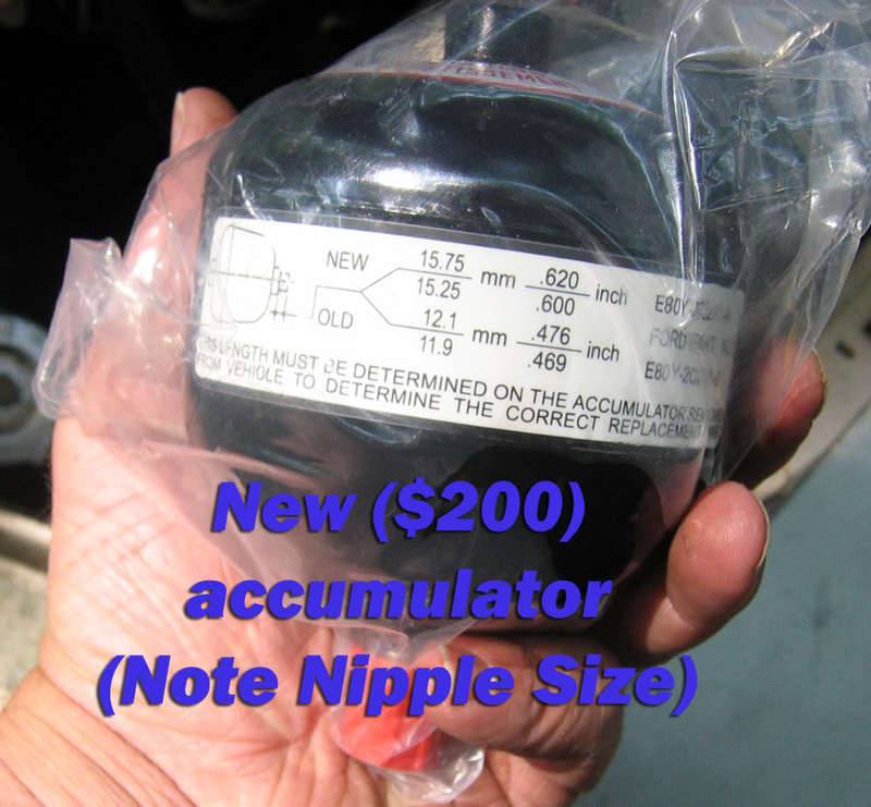

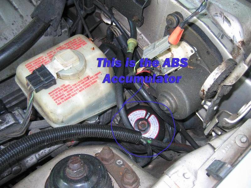

I had the same problem. I ended changing out the accumulator with a new one from the dealer. I was told that the 88-92 Mark VII's used the long nipple accumulator. This was really good for me since the car is an 89 and they don't stock the short nipple version any more.
I was really hesitant to buy a new one because the part is about $200.
If your abs pump runs every time you hit the pedal and the rest of the system works this is your problem. If you start the car and don't touch the brakes, then start driving and the light turns on the instant you hit the brakes then this it your problem. If the light turns on the instant the car starts rolling then you might want to check the wheel speed sensors.

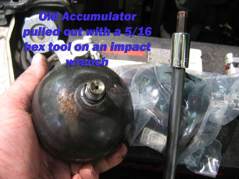

I went through all the abs actuator trouble shooting steps and that all check out so I bought the accumulator. When I put it in the problem was solved. :)
It was a simple install. Hit it with an impact hex wrench and it comes right out.

I am so loving your posts! A picture is worth a thousand words and it also takes the GUESS WORK out of jobs like this.
Thank you, thank you, thank you for the instruction!
