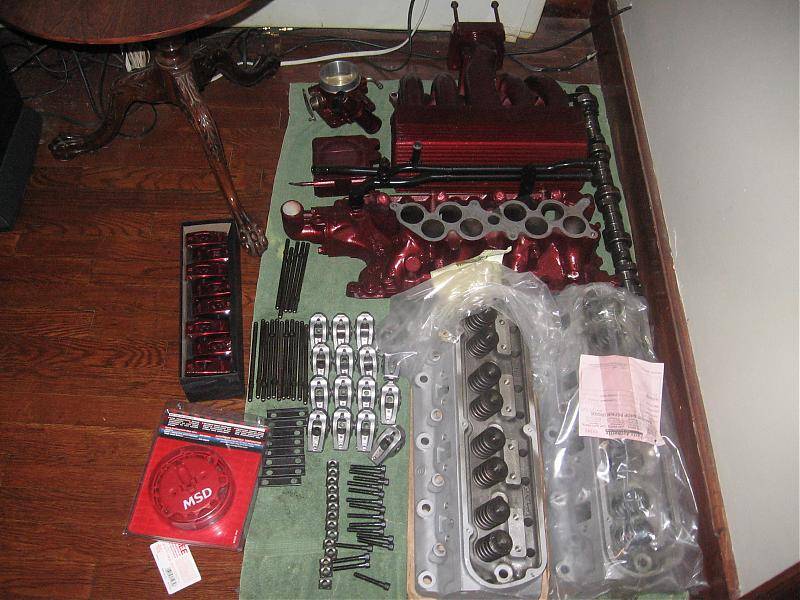

You can go mas air with mustangs c.p with 19 injectors an 9mm wries that is what I had .new I am going 347 24 injectors and A.F.R. heads:shifty:
