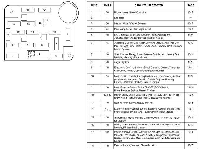

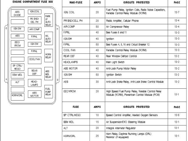

:bash: We do not have a owner's manual for the car but this the problem: Everytime we start the car a 20-amp fuse blows, we've been told this fuse is for the fuel pump but aren't sure. We switched out each relay since we weren't sure which one was for the fuel pump and the 20-amp fuse still blew. Then we disconnected the fuel pump & sending unit and the fuse still blows when you try to start it. We need a fuse box diagram to make sure this fuse is for the fuel pump and we need help!!
We've looked everywhere local for a Chilton's or Hayes book with no luck!!

Try these...
