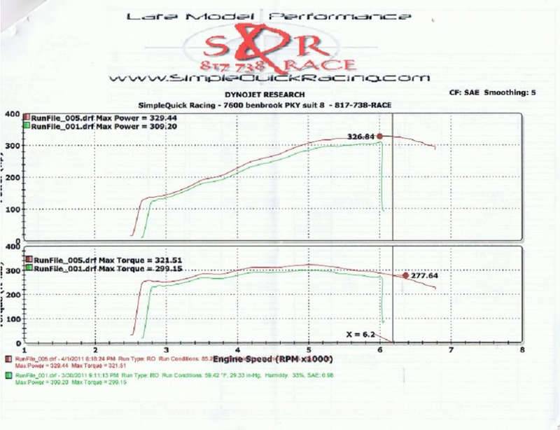

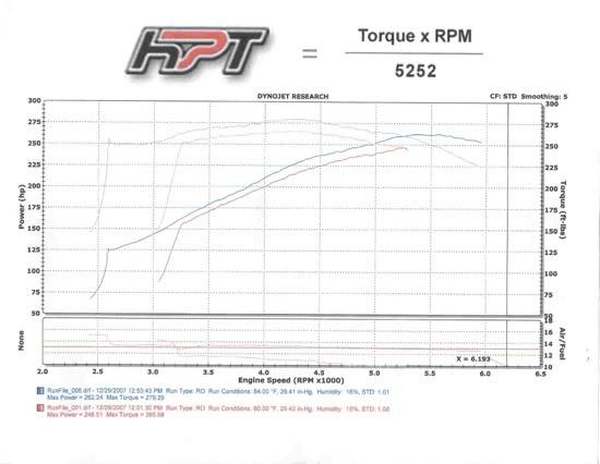

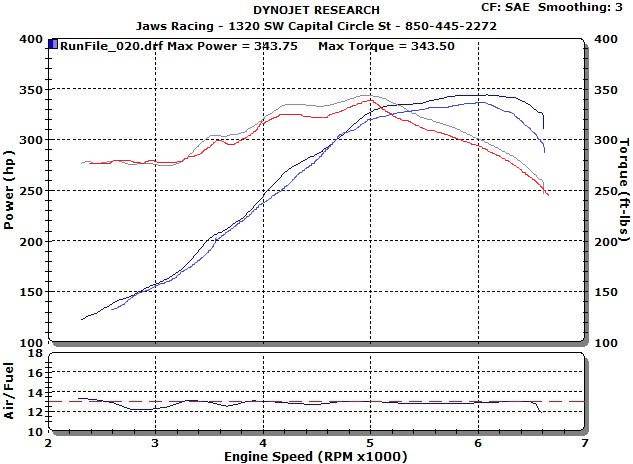

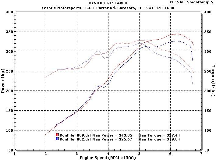

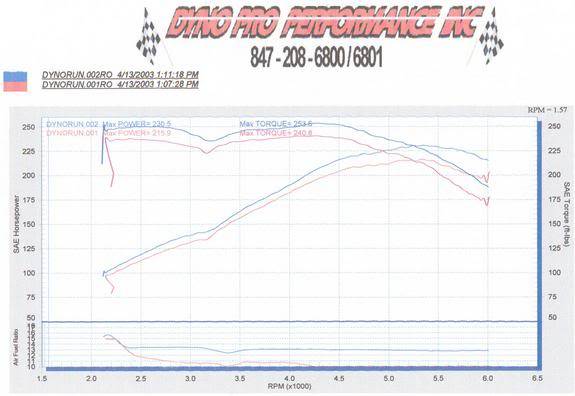

Here are some graphs of the "Cobra Cam Swap"; worth about 20hp and about the same torque - worth it IMHO... I believe only one of them didn't degree in their cams...
Here is a couple of Mark VIIIs:
Here is a few Mustangs with the swap:
