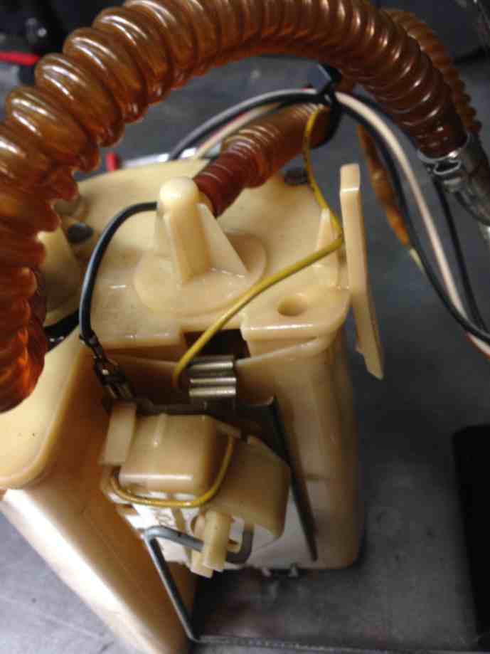

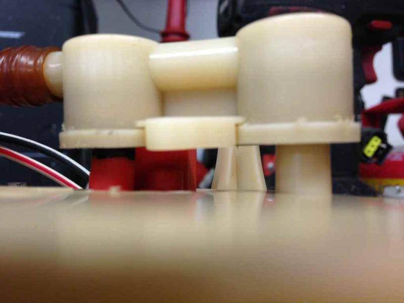

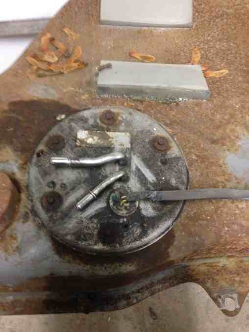

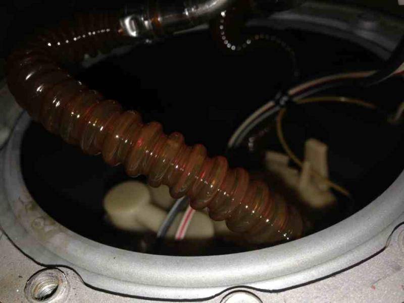

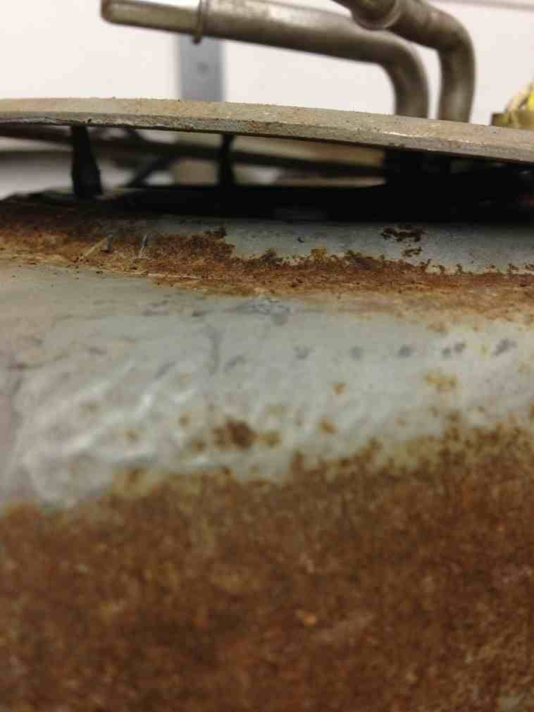

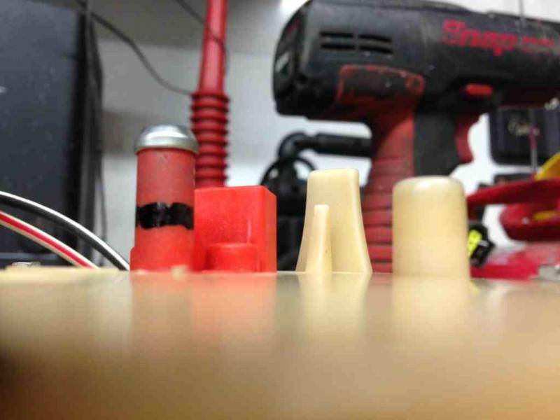

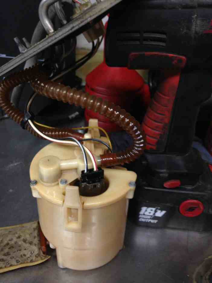

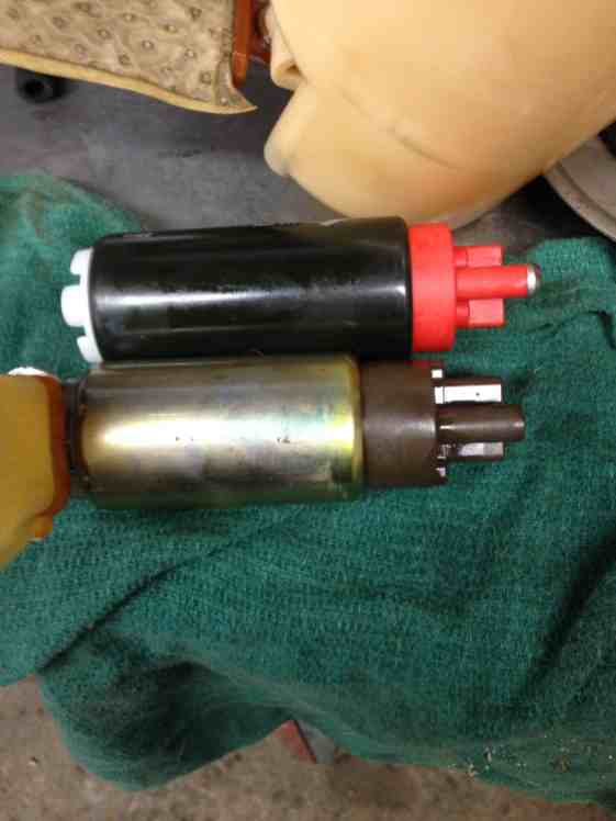

Here are some pics if it helps you. I put it an AEM unit because I had too. I got by without changing the gasket. If you can keep the rubber gasket from getting soaked in fuel It goes a long way in it not getting deformed/swelling.
