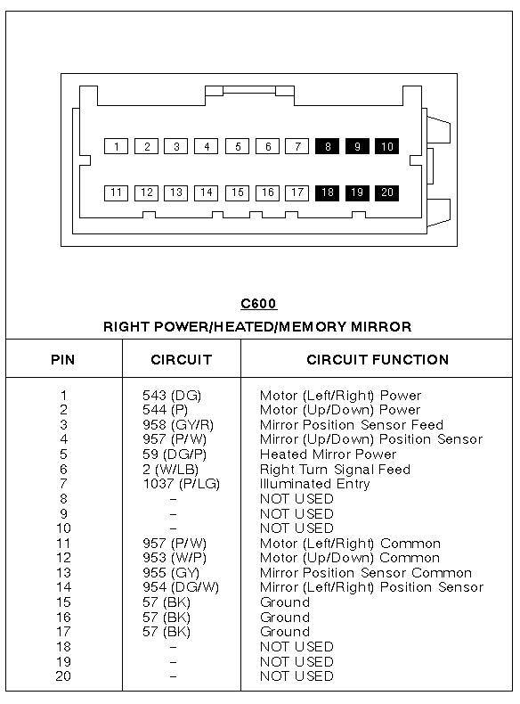

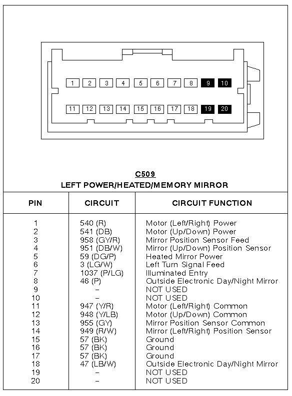

SATURN5 Dr. Frankenstang Joined Oct 10, 2009 Messages 1,166 Reaction score 29 Location in the shop Jun 10, 2017 #1 Anyone have the diagrams for the gen 2 door mirrors? I found an old thread but the links are dead. Thanks.
Joeychgo Administrator Staff member Joined Mar 2, 2004 Messages 6,044 Reaction score 193 Location Chicago, IL Jun 10, 2017 #2 link me to the old thread
SATURN5 Dr. Frankenstang Joined Oct 10, 2009 Messages 1,166 Reaction score 29 Location in the shop Jun 10, 2017 #3 need wiring diagram for mirrors
Joeychgo Administrator Staff member Joined Mar 2, 2004 Messages 6,044 Reaction score 193 Location Chicago, IL Jun 10, 2017 #4 Came across these.... Schematics for the Lincoln Mark VIII 1997-1998 mirrors
