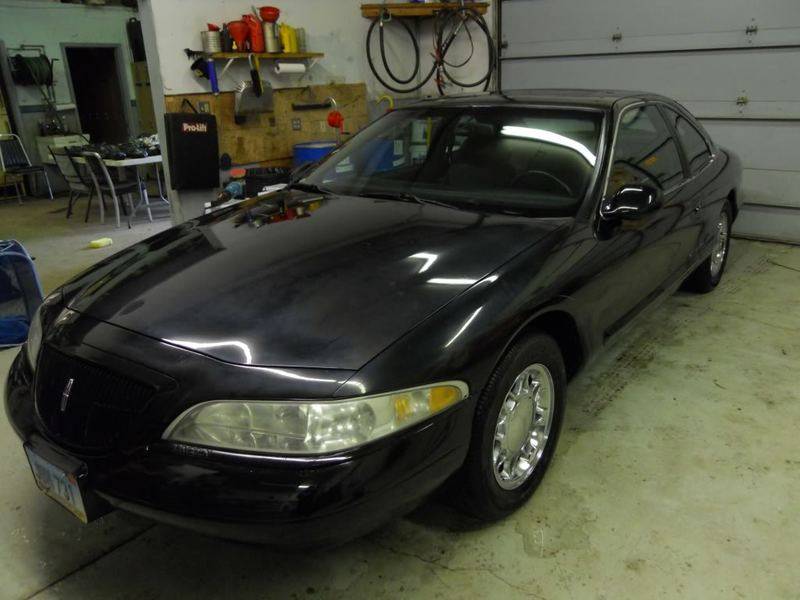

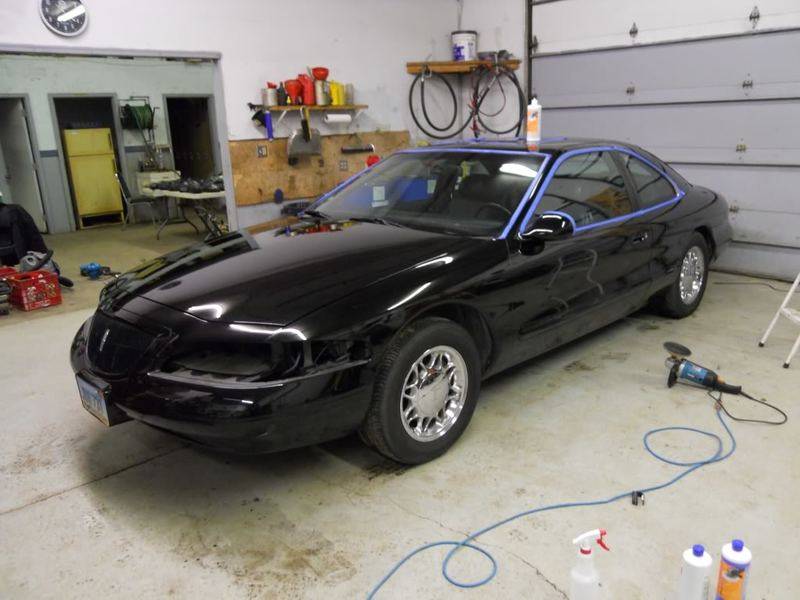

So Ford Nut picked up this LSC from Nobody Special... had a few issues. typical Gen 2, burned out low beam, bad blend door, neon is out... and it was a little hammered...
So 24 hours later the car was detailed, had two working HID's and heat... and then the fuel pump died... dead in the water right in the shop! Well the Walbro is on the way... should be running by this weekend... on with the pics!

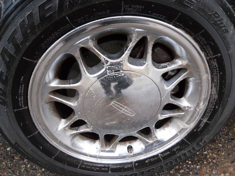

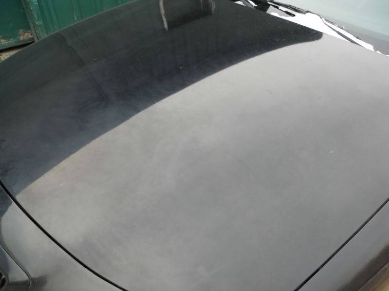

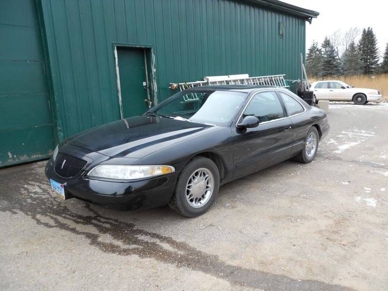

Condition when I received it

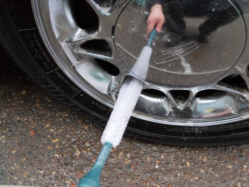

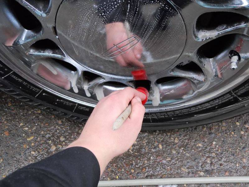

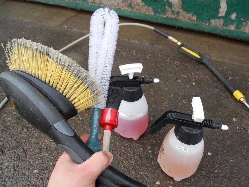

On with the washing!
Pulled it in the shop... wowza!

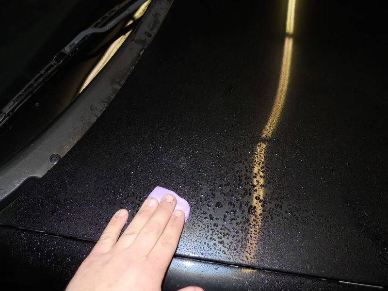

Clay... CG purple pulled up a lot of junk
CG water spot remover in action!

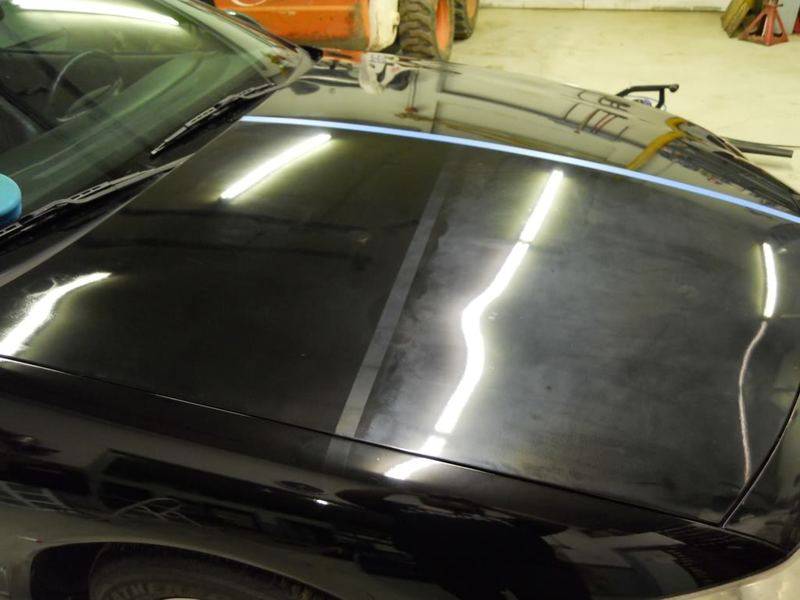

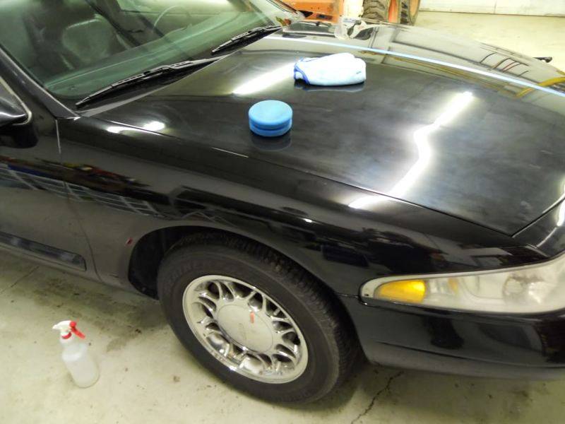

After claying and water spot remover I taped it up for polishing.

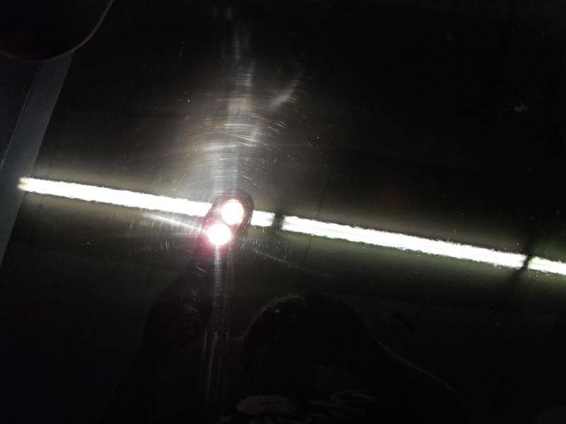

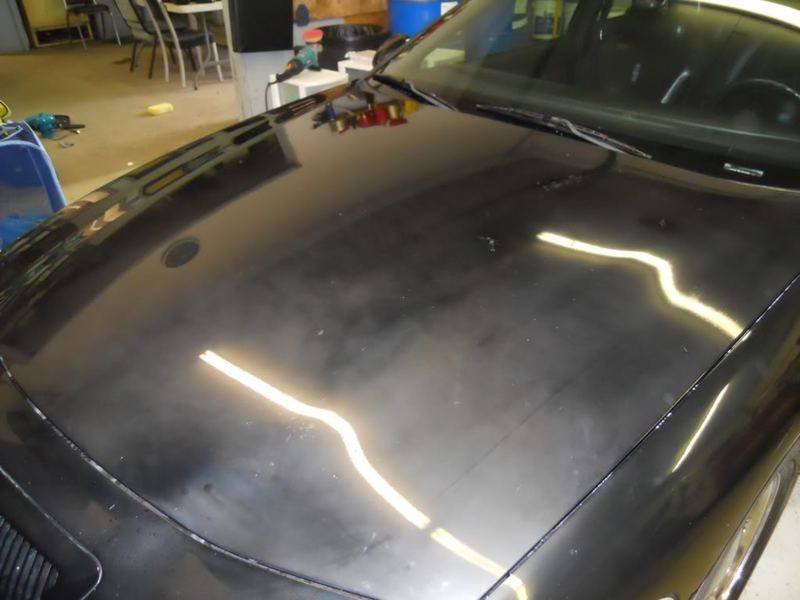

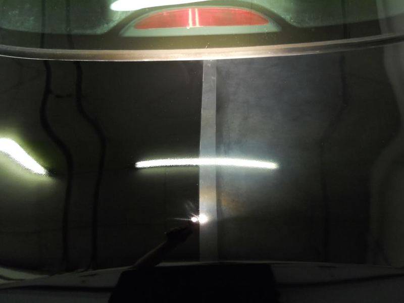

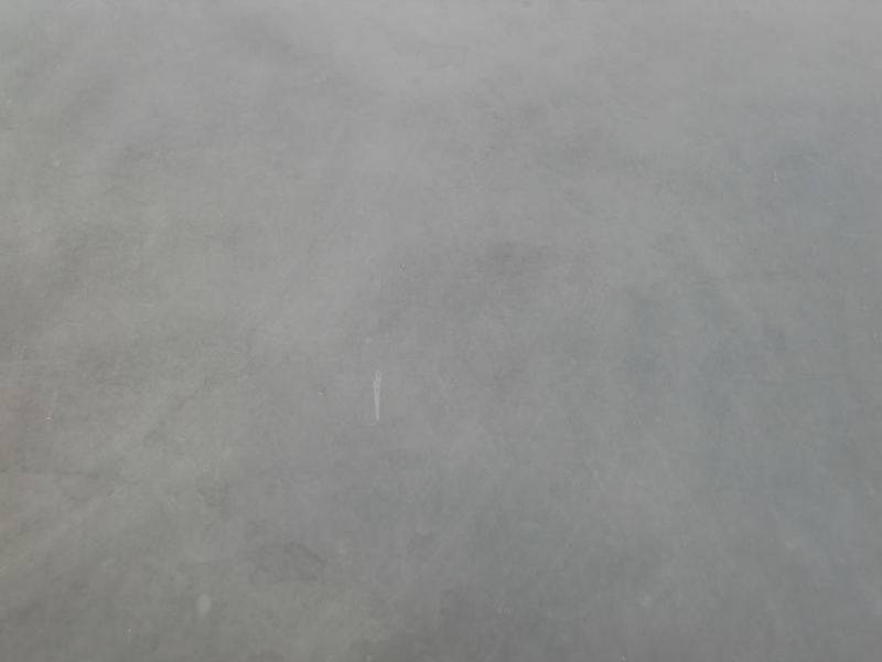

These are paint condition shots after one pass with wool and Menzerna SIP, there was no point in showing a bunch of pics of oxidation...

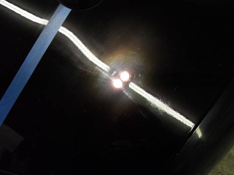

Here is the only 50/50 I took... good stuff!

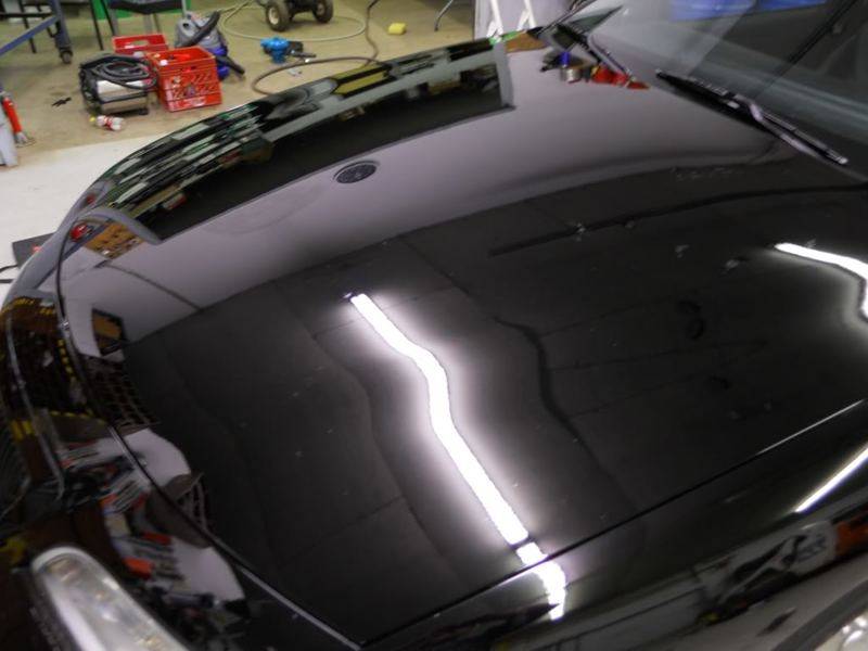

After a full go around with the wool and SIP

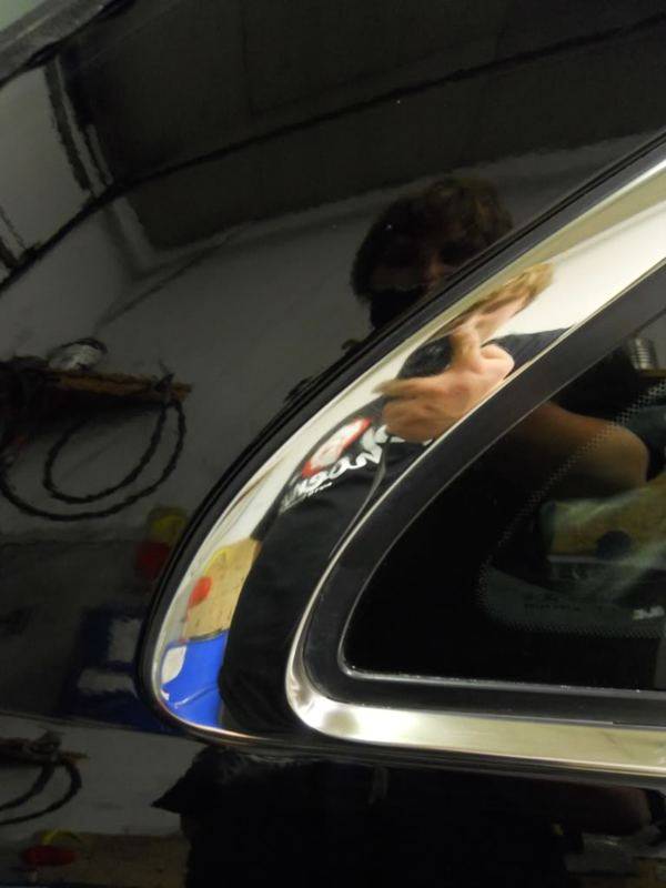

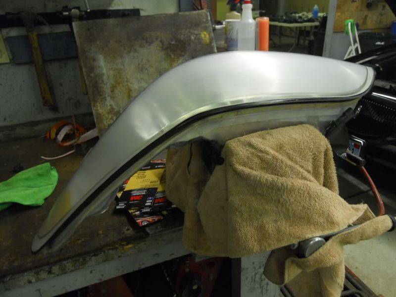

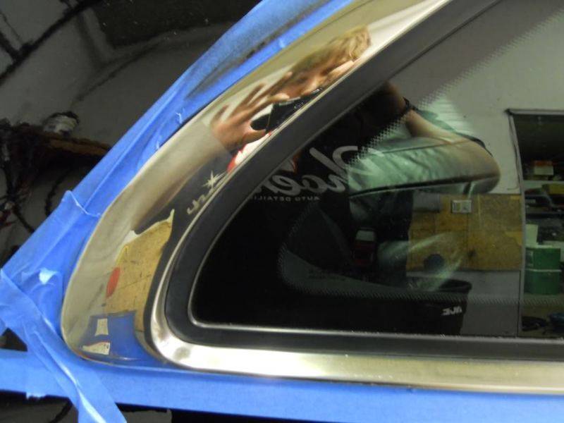

Due to the sloppy prep and body work someone nailed the window garnish with a da... I used a 75mm rayon pad with Autosol metal polish

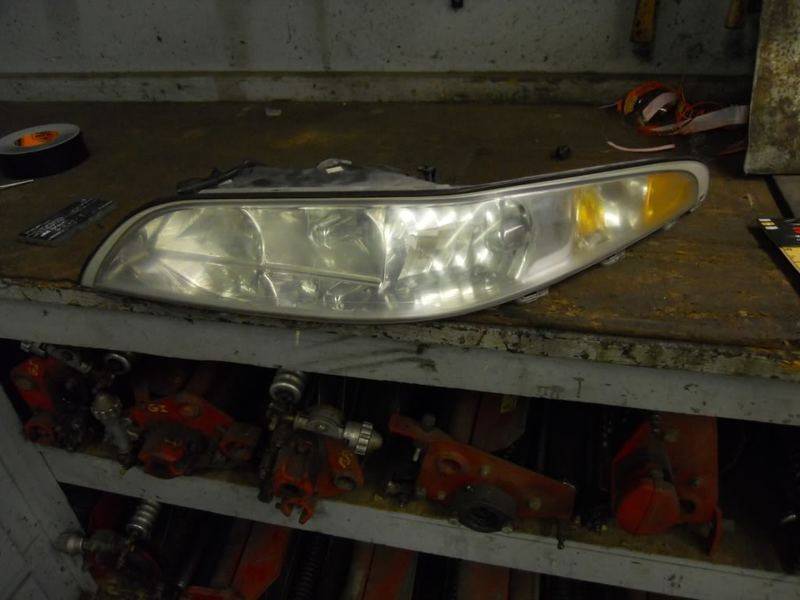

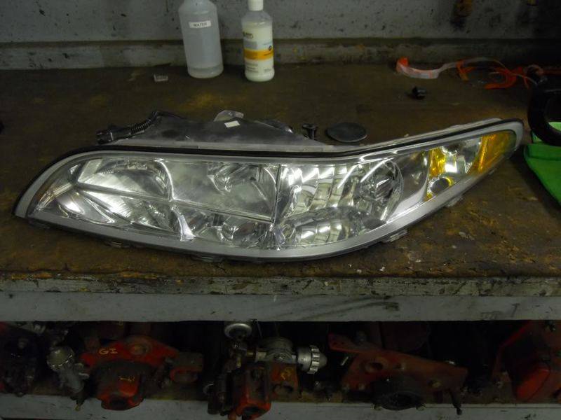

The headlights... typical of gen 2's... I hit them with 600, 1000, 2000, RB Blue and PG, and Uber Green and PF.

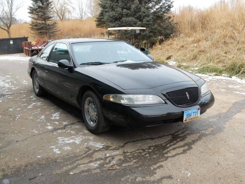

Here are some afters... I topped the car with Jeff Werksatt Acrylic Jett, the hood had some nasty defects that I couldn't do anything about... but overal it looks great!
I've sanded headlights up to 2000 as you mention and I thought they came out great, but I'm not familiar with RB Blue and PG, and Uber Green and PF - can you enlighten me as to what they are, and how they are used?
Rubbish Boy's 100mm blue cutting foam pad, Menzerna Power Gloss, Uber Green Polishing Pad, and Menzerna Power Finish.

The molding was just trashed I thought for sure I would be replacing this.

Very creative with the rayon pad and autosol too. I'll have to remember that.
NICE work Brandon! btw, you pocket dialed me while you were polishing. lol.
Ben gave me that tip... he also told me I should pick up some Dodo superfine meta lpolish and use it on wool to finish it out...
I was wondering about that product. I believe it's part of the Supernatural line.
