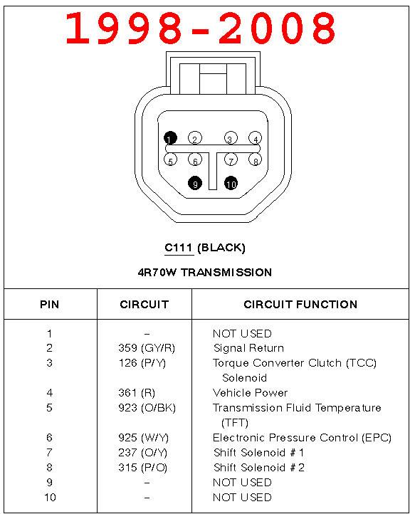

How hard is it to do the repinning when putting a 98 trans on a 94? Easier to just splice or does it really need to be pinned?
why would you "cut and splice" wires when it's so elementary easy to pull the connector apart and move the pins?
it's "fisher price" easy.
Someone else on here mentioned it being easier to cut and splice. They must have been from Alabama too.:)
Had another user on here that said it was a "PITA" to do the pinning. I haven't really looked at it yet so I didn't know. I don't even know what the pins being moved are for. All I know is that they have to be moved and the 3-4 shift solenoid that plugs in has to be swapped out I think. I changed that myself 4 years ago because of an O/D problem which is still fixed. If the pinning is "Fisher Price" easy, I might just get these 2 swapped out within the week.

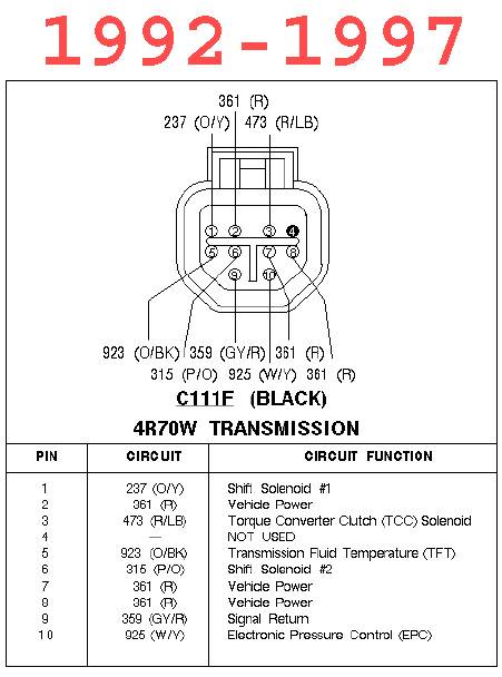

the PITA on the re-pin is in the TCCOA article the pin out diagram is WRONG.
well by WRONG I mean it's backwards, someone scanned or took a pic of the diagram and it got screwed up reversed, whatever...WRONG..lol
I dont tell people how to do it right because there is to much at stake.
on one of the panther P71 boards there is the correct information regarding the different years and their pinouts.
one of the main differences is the first gen trans has 3 postive wires RED going in..on the 98 trans there is only 1 positive RED going into the trans.
You have to pull those other two out of the connector...you dont want to "cut em" either, you want to remove the pins completely.
There are reasons for this, it's irrelevant to the fact and far too much to type (this is already a novel)
The pin out is stupid simple when you have the correct info.
it's far more stupid to hack and cut WAAARS rather than doing it correctly.
IMHO
AWww hell..
These images were borrowed from this webpage which is a good read
http://www.p71interceptor.com/tranny/diagrams/electrical/external/bulkhead/index.html
all credit goes to those at p71interceptor.com
Tommy, I'm glad you told me about those pics being wrong or scanned backwards because that's what I was going to go by. :rolleyes: Not speaking of the ones above but from the TCCOA article.
