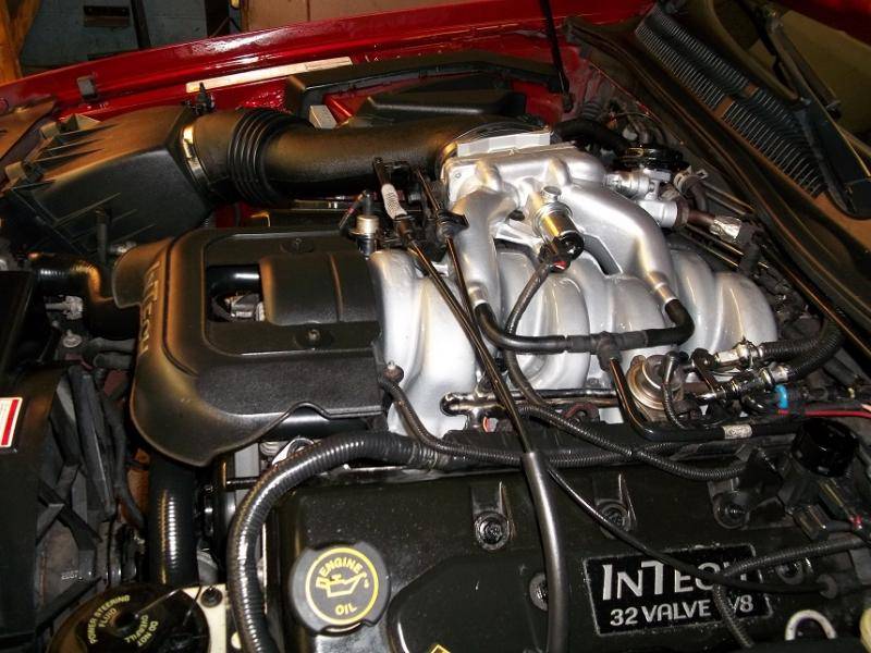

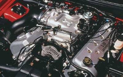

im still planning on the c head swap on the 98,my question is on the intake, the throttle and cruise cables look like they are in the same location,am i right i should be able to reuse the cables. i believe ive asked this before, but since the 03 is returnless, i should use the fuel rails from the 98 or do i have to make custom rails? ive got everything else pretty much worked out.
03 cable location...
98 location...(i used dbleb88 pic good work)
98 rails CAN beused. You'll need to modify the mounting tabs, and possibly cut off the pushlok hose connecting the 2 halves together to lengthen/shorten them.
mike what do you recommend since i want/need to retain return style fuel system. you are familiar with what i want to do, the mach 1 intake has rails that end up with one end.this includes egr. or should i delete it?help please
Since J just informed us they won't work.....(Thank you much!)
I would buy aftermarket rails, regulator, and lines and fab it to work.
