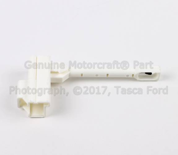

Those were prime conditions for the evaporator to freeze over, and your symptoms match well with that happening. Of course, that could never happen because there is an evaporator temperature sensor. When it reads close to freezing, the DATC turns the compressor off till the temperature comes up a bit. I think that your evaporator temperature sensor has failed. I've had to replace it on both of mine, and I know of a few others as well. It's a little bit of a pain to get to, but it can be done without removing anything else. It's on the side of the air box the evaporator and heater cores are in, up high on the driver's side. You can reach up from under the dash to get to it.

Is the resistance within the specified values for these temperature ranges: 10-20°C (50-68°F) 37,000-58,000 ohms; 20-30°C (68-86°F) 24,000-37,000 ohms; 30-40°C (86-104°F) 16,000-24,000 ohms?
The ones I have replaced have been way out of range.
I actually have the last one I removed still sitting on my desk. It's 72F, and it's reading 53 ohms.
XW4Z-19C734-BA
